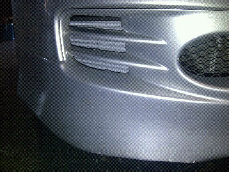

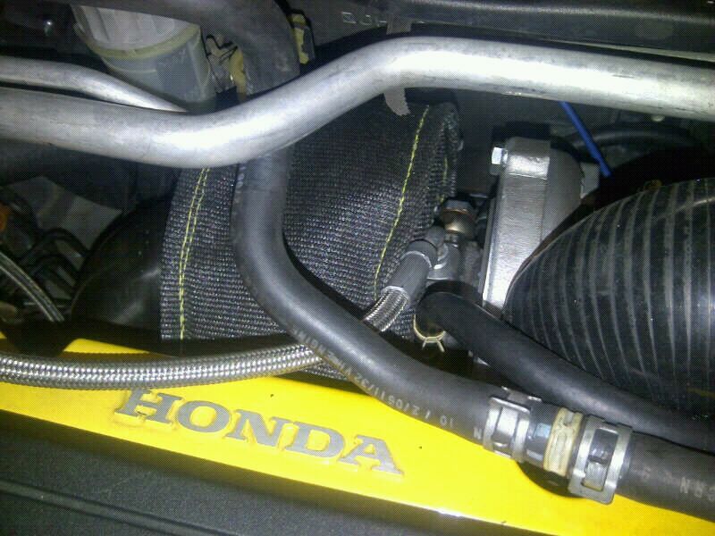

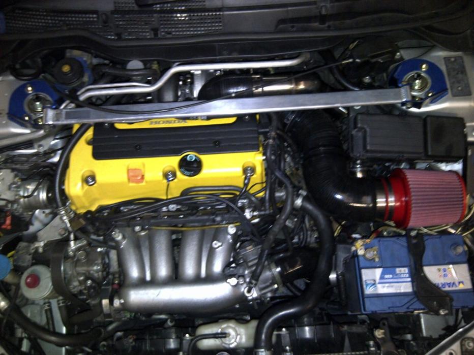

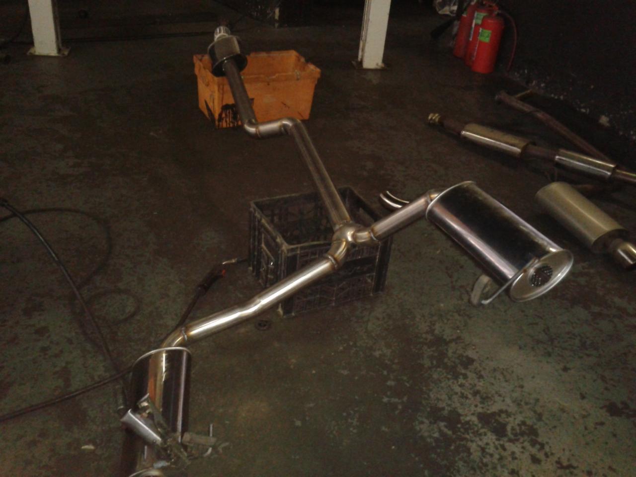

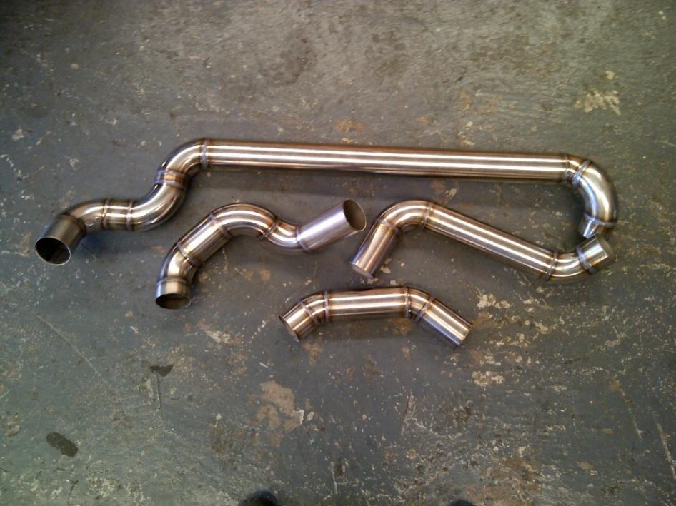

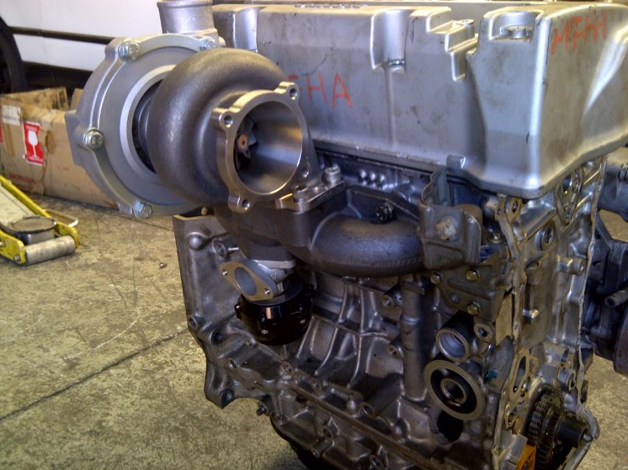

    hey guys,
    new to the forum and wanted to share my recent build.
    I have a boosted k24a3 (south african Honda Accord - CL9 chassis).
    My setup is as follows:
    GT3076R turbo
    RC 750cc injectors
    Eagle rods
    Wiseco Pistons
    ACL Race Bearings
    K20 oil pump
    Toda Tensioner
    oem cams
    Skunk2 valve springs and retainers
    stock block
    3" downpipe and exhaust
    Wahlbro fuel pump
    Precision wastegate
    Tial dumpvalve
    ECU :
    Kpro
    Brakes:
    Powerbrake discs front and rear
    POwerbrake braided brake lines
    EBC Yellow stuff pads front and rear
    Spoon front calipers
    Transmission:
    Stock internals
    Competition stage 4 clutch and flywheel
    Wavetrac lsd
    Suspension:
    BC Racing BR-RS coilovers
    Cusco front strut bar
    Progress Rear Sway bar
    Currently running 0.6 bar boost, with approximately 300whp.
    will confirm power figures later in the day.
    Guys, tend to manipulate power graphs here so going to an independant place to do a dyno run.
    Some help here please:
    1. Would the RBC or RBB intake manifold be best for this set up?
    2. What is power would the stock block, driveshafts and transmission be able to handle?
    ps: this is a daily drive, so i am looking for reliable power.
    any thoughts will be greatly appreciated.

    Great build buddy!
    loving the setup, your engine bay is so clean
    you got any youtube clips? would love to see how it runs!

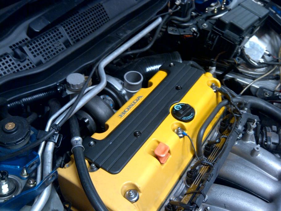

    How and where have u plumed ur cooler piping .....thers no space ....
