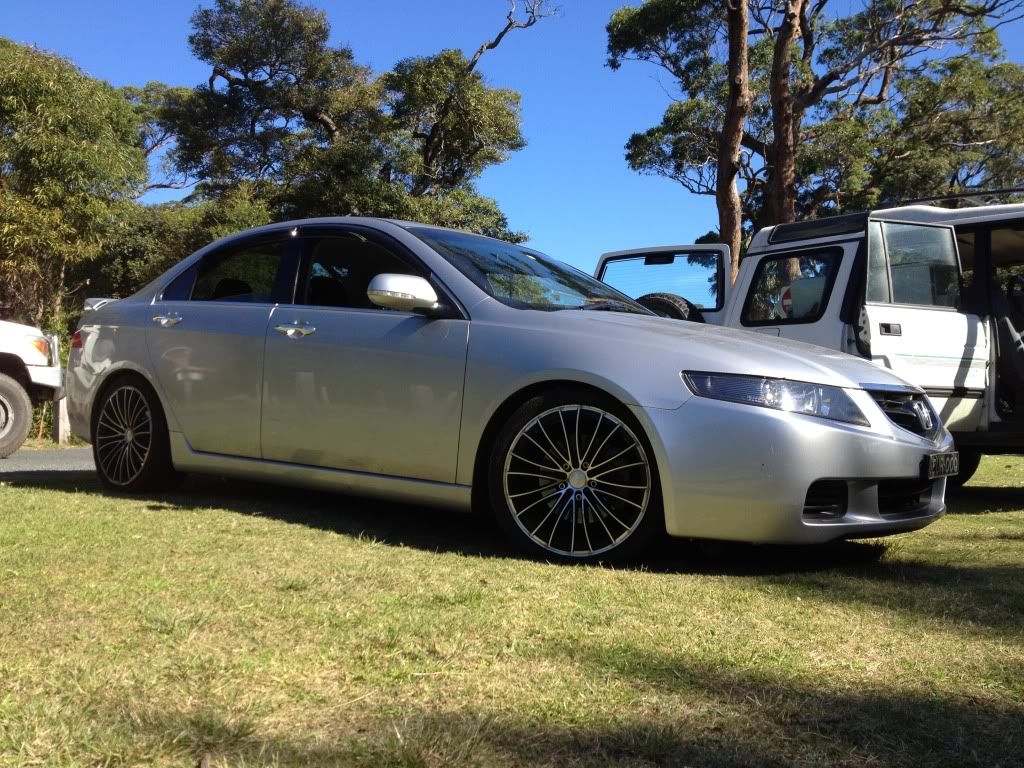

    From memory, the drop from stock height is:
    H-Tech: Front 1.0" Rear 0.7"
    S-Tech: Front 1.7" Rear 1.3"
    I don't think you're going to achieve this look with either of them. I have S-Techs on my CL9, check it out:
