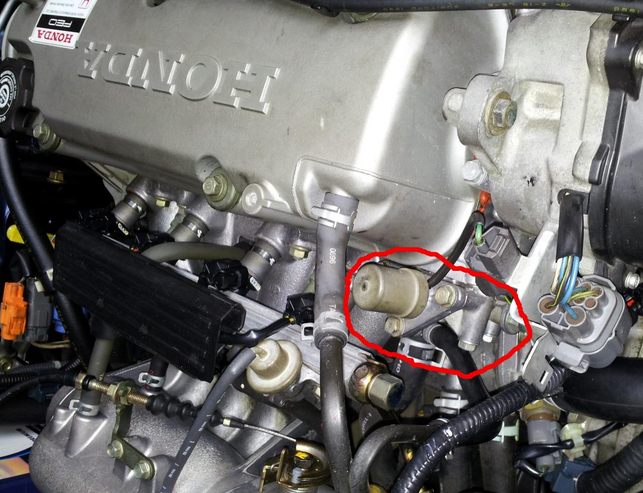

    My Engine Oil is leaking from the red colour indicated part shown in the attached image.
    I do not know the name of that part but Oil is leaking beneath that part.

    if its that change the vtec solenoid gasket and while you're at it change the dizzy o ring both should cost 15bucks together max

    this is for the vtec gasket http://www.d-series.org/forums/diy-f...eplacment.html
    this is for the dizzy o ring http://hondaswap.com/general-tech-ma...-o-ring-81866/
    quiet easy to do imo

    Heres what the seal looks like
    you can replace it yourself easily,just google a DIY

    hmmm if does ek1 have vtec solenoids too? Are you sure its from that area and not coming from your transmission area?

    get a cloth and brake cleen and wipe up all the dripping excess oil from the area, (everything), then run the engine or a little drive and then you should be able to pinpoint the exact spot its coming out from

    I tried that a few times & unable to find out other than from beneath the area under Vtec Solenoid Gasket.

    i looked at the car today its leaking from all around the head and bogs down threw the rev range and has no power whats so ever he needs to either replace that motor or take the head off to see whats wrong with it imo
