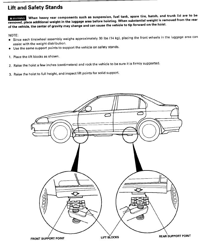

    Right from the workshop manual.

    Found it!
    Interesting, my manual only had the side support points. But I needed that place to hold the jack stands (going to buy a jack + stands soon) just to keep it on the safe side.
