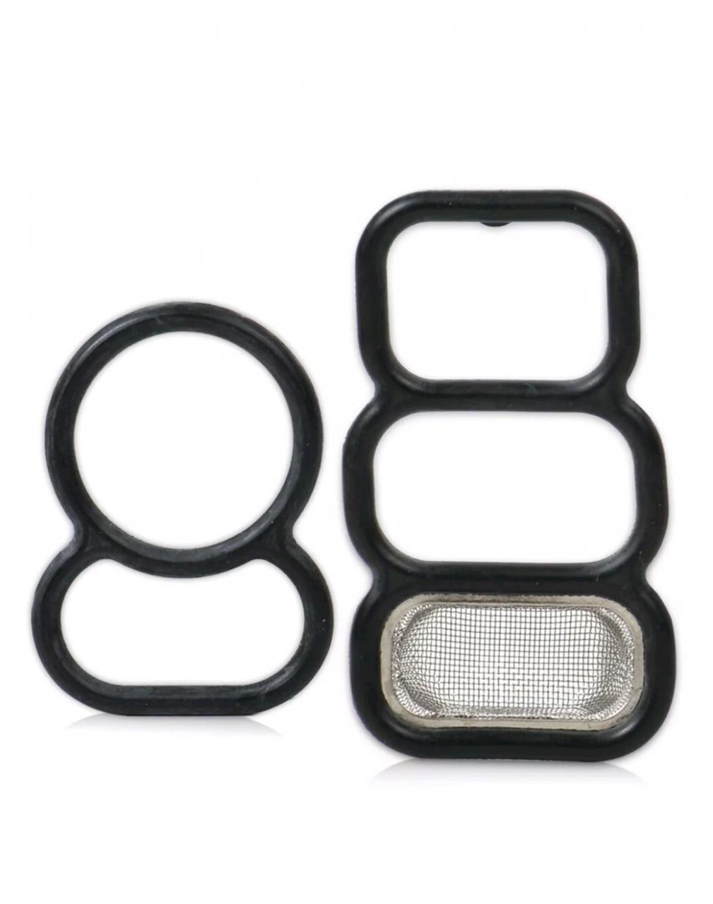

    Vtec solenoid. Very common leak.
    Upper and lower seals about 40bucks
    DIY install
    Any idea where I can get this from? I contacted two Honda dealerships and they wanted $61 for the big one and $20-36 for the small one...
    Part numbers:
    15815 PR3004
    15825 P08005
    Sent from my SM-G930F using Tapatalk

    Quote Originally Posted by dc2r View Post
    Part numbers:
    15815 PR3004
    15825 P08005
    I got mine from this seller https://www.ebay.com.au/itm/Genuine-...X/202299716509
    don't get that one though,it's B series
