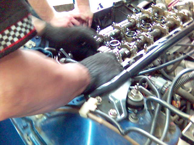

    Remove the cam plastic cover and then take out your spark plug booths and remove the valve cover and put it aside. Clean off any excess sealant off the rubber gasket.

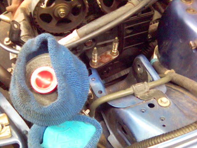

    Next remove your passenger side engine mount. There is one bolt that holds the mount to the chasis and 2 nuts that hold the engine to the mount. Then engine will 'drop' a little once you take this mount out but that's ok. It is still supported by the lower mount (underneath).
    You might have to move your PS resevoire out of the way.

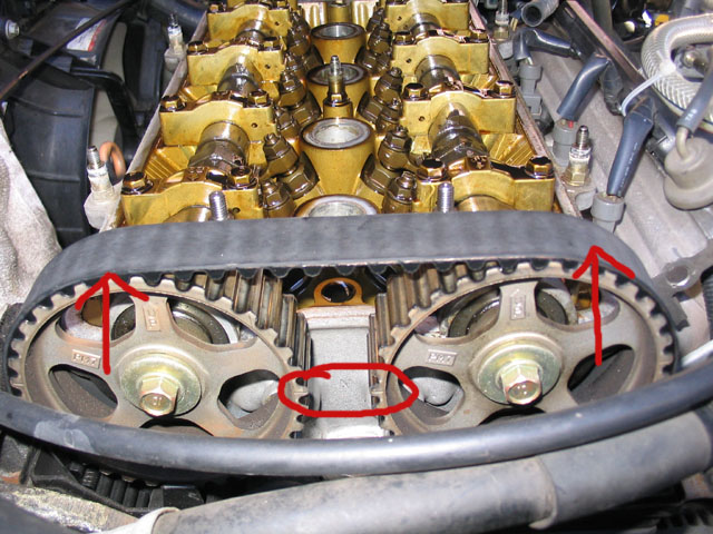

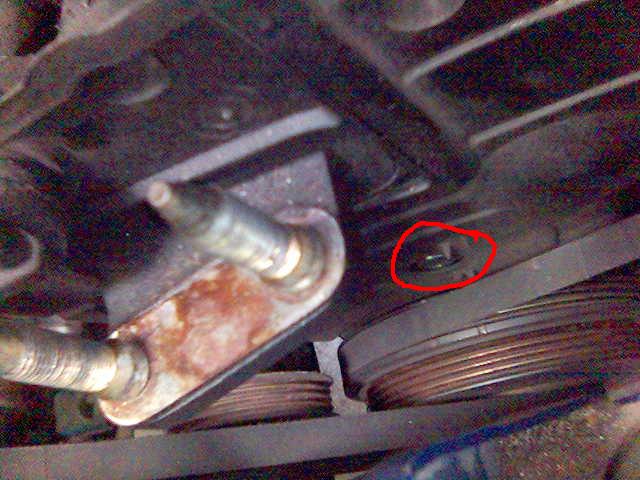

    Bring #1 cylinder to top dead centre by turning the crank pulley (use a 17mm socket and extention + a breaker bar to turn the engine counter clockwise till you reach TDC (the "UP" arrows on the cam gear point up, and the little indents on the cam gear should be parallel with the head). You can double check TDC by making sure the white marking on the crank pulley lines up with the marking on the lower timing belt covers. (no pic sorry).

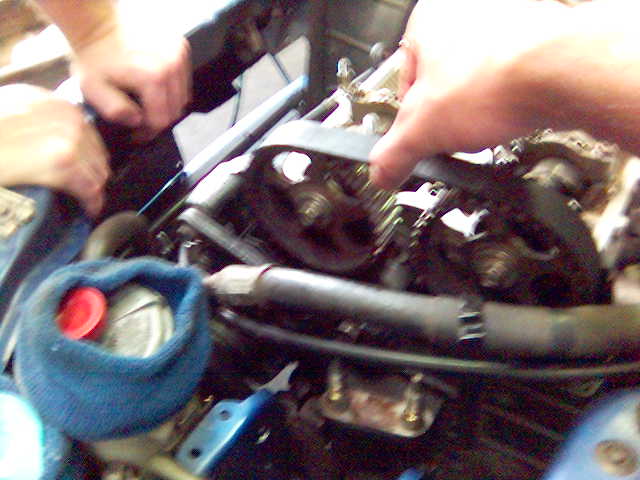

    Loosen the tensionser pulley bolt (DO NOT REMOVE it!). Once this is loosened, we should be able to loosen up the timing belt so we can slide it off the cam gears. (see pic after next)

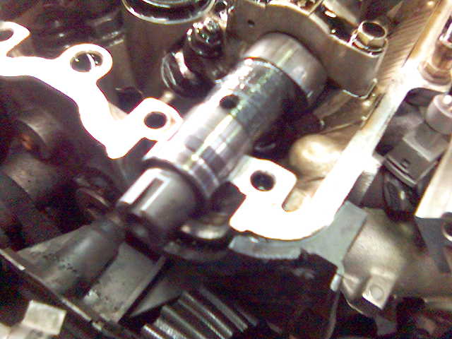

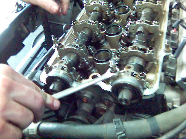

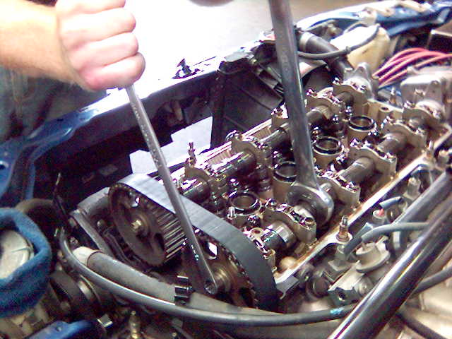

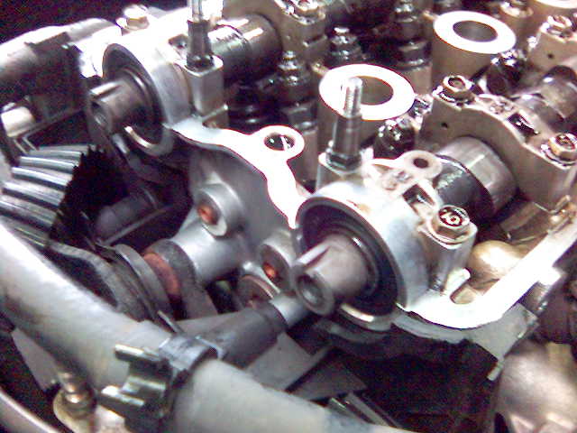

    Once the timing belt is loose, use your 27mm open ended spanner to hold the cam shaft (there is a special hex portion of the cam shaft you use for this (see pic)). Then use your socket + ratchet to loosen the cam gear bolt. Don't remove the cam gear + bolt just yet.
    Repeat for exhaust cam gear.

    You can now proceed to slide the timing belt off the cam gears by carefully pulling the timing belt towards you. Once its off....move it out of the way. Twisting it outwards a bit will help it stay out of your way.

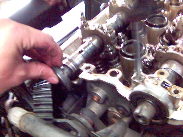

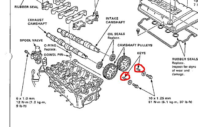

    The next step is to take the actual cam gears off. This is quite simple and they just sliide off the end of the camshaft. Each cam gear has a 'key' that is used between the cam gear and the cam shaft so be sure you don't loose it /drop it within the timing covers!

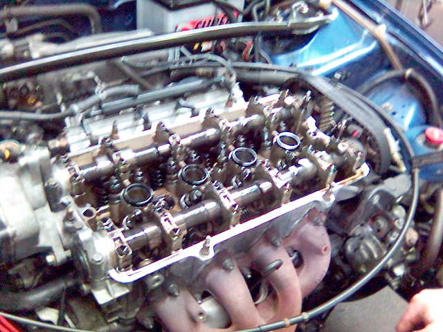

    7. Undo the 4 bolts holding the cam shaft down. You will need either an open ended spanner or a deep socket for this. Once the bots are out, you can put a screwdriver into the holes and rock the holder a bit from left to right to get it loose.
    8.
    Carefully slide the old rubber seals off the end of the camshafts.
    9.
    Use a clean cloth to clean the area where the old seals were and around the end of the camshaft.

    Put the camshaft keys in place on the camshafts (make sure you put them the right way) and slide the cam gears back on. Hold the camshaft in place with the 27mm open ended and torque up the cam gears to spec.
    NOTE: To make sure the cam gear/shaft are at TDC , you can insert a pin punch through the camshaft holder into the cam to make sure it is aligned correctly. If done properly, both "UP" arrows should be pointing straight up like when we first started before taking the belt off.

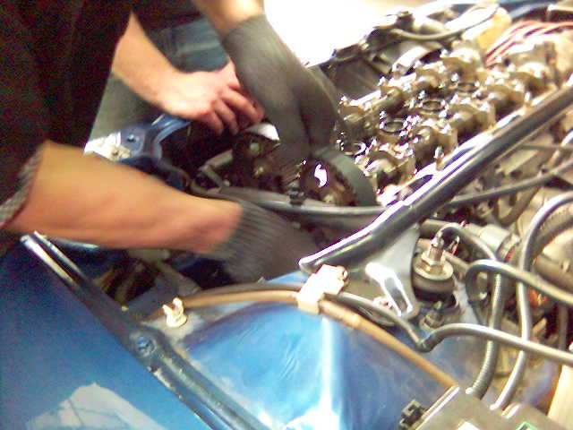

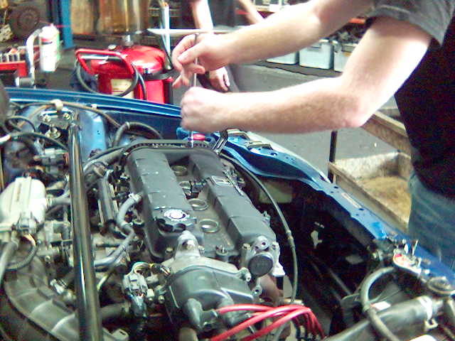

    12. Slide the timing belt on similarly to how it was removed. Double check that Cyl #1 is still at TDC (both via the cam gears AND the crank pulley marking) and that the belt hasn't missed any teeth on the cam gears.
    Should look like this:

    hey those piccies we're taken in Hanny's eh!?
    i swear i recognise the workshop...and the shirt..
    and i think that is peter workin on the car isn't it? he always uses those gloves..
    Needs more time... Array
    Blog Entries
    12
    Pics updated.
    ANd YES to both of those questions above
