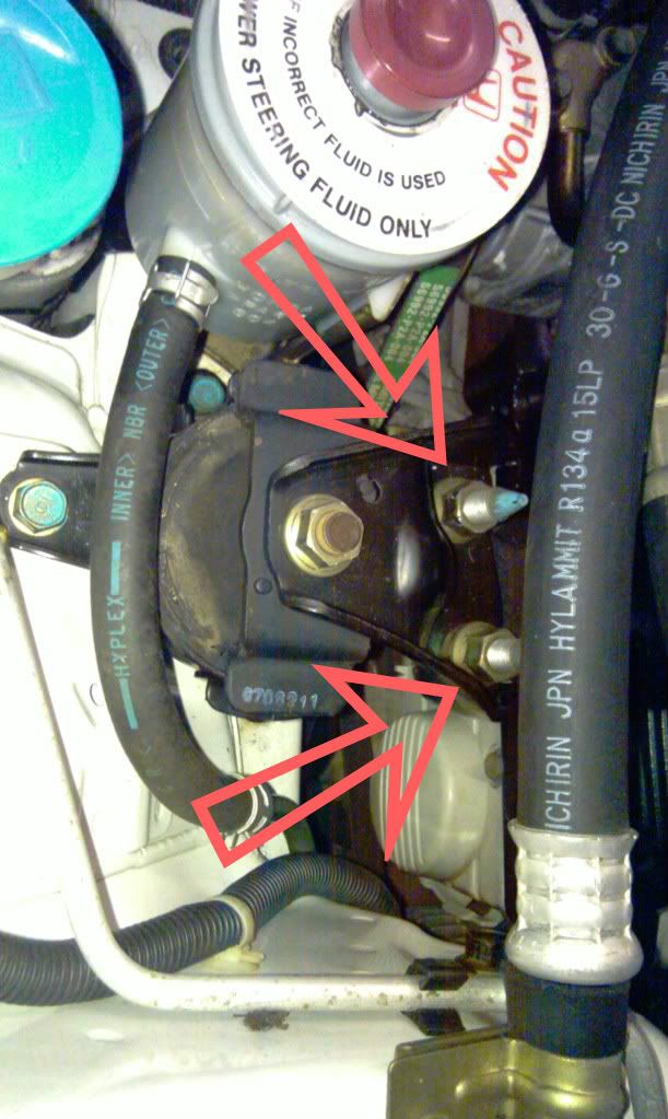

Thanks for the tips ;) Also i noticed they say 2 bolt or 3 bolt whats the difference?
Its to do with the passenger side engine bracket, some came with 2 bolts some came with 3 depending on model etc, if you look at you passenger side mount you will be able to see if your has 2 or 3 bolts, should be 2 IIRC but better to check as you only have to lift the bonnet so not hard to check.
Heres a pic of mine before i changed to hasports, ive pointed out the bolts, they are the ones closest to the engine, mine is a 2 bolt as you can see, if yours is the same then its 2 bolt.
http://i1220.photobucket.com/albums/...IMAG1247-2.jpg
It's not dependent on model. All EK came with 2 bolt.
Reason they offer 3 bolt is if you have a B18C swap.
