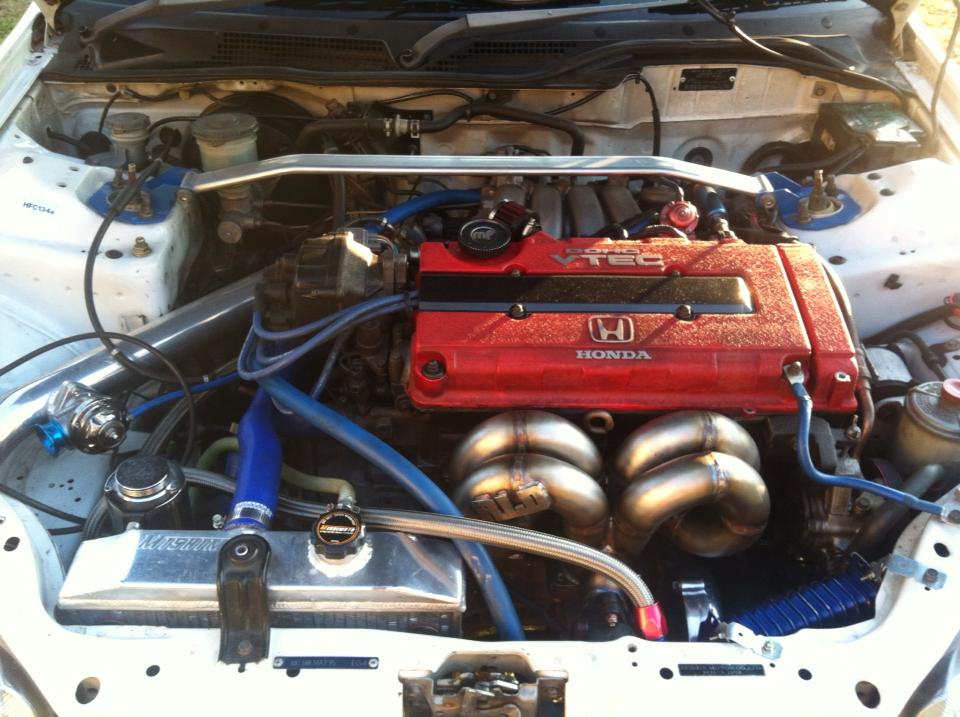

		I've been contemplating and doing research on going turbo on my current motor. I'm not in a rush but I am keeping myself to a budget of sorts (i.e. save money wherever possible). I'm looking to retain my use of a/c and p/s but I have a few questions regarding manifolds and turbos.
At the moment my motor setup is as such:
