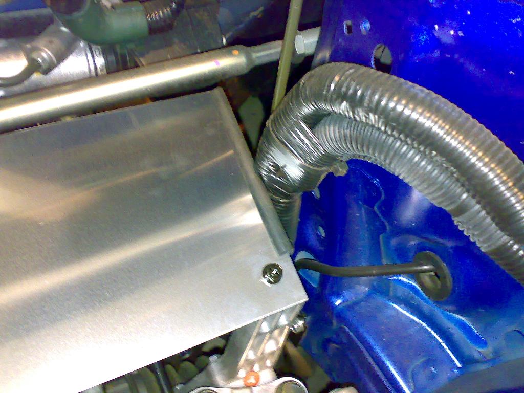

As someone posted b4 that the heat shield cuts into the wiring harness, I have Cut a small rubber hose and auto siliconed it to the edge that rubs,
http://www.ozhonda.com/forum/attachm...3&d=1180681812
Cowl top off
http://www.ozhonda.com/forum/attachm...2&d=1180681812
looking good, get some pics once done :)
