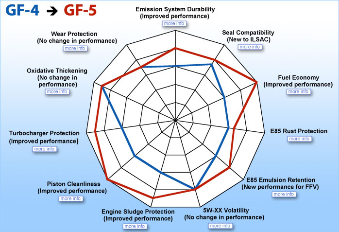

It seems that the CU2 (K24Z) engine’s oil specification is to be changed as mentioned in this youtube clip from Honda. At 50 seconds, Jeff Jetter, mentions Honda’s plan to move to 0W20 oil retroactively to 2001 for most of it’s vehicles.
http://www.youtube.com/watch?v=OAYkigNbzgs
The new Group 5 oils are rewriting history it seems and I plan to fill with 0W20 at my next oil change and have the added bonus of better fuel economy.
So what about the post combustion sound (PCS) problem?
It seems that the low viscosity numbers allow the engine to rev more freely without labouring and the cooling effect of a lower viscosity oil as it flows more freely.
The new GF5 (Group 5) oils are now becoming available in UK & EU. I would think that they can be found in USA too. As you can see from the spider chart below there are many advantages to using GF5 over GF4.
Both Amsoil and Total have GF5 oils in UK but you need to check the specification of the formulation as GF4 is still being sold.
Note: Engine oil cannot be shipped overseas due to it being a flammable liquid.
I will be changing to GF5 in April (12 month interval) and plan to use 0W20. It is also a good idea to do the oil change in Spring as very cold weather can be pretty tough on an oil (separation of waxes etc).

So, here it is.... Amsoil 0W20 GF5 SN rated oil, which I put into my engine today.
Why did I choose Amsoil 0W20?
* 100% Synthetic. There is no word play, and any attempt to pass off hydrocracked mineral oil as synthetic oil.
* Extended drain interval of 25,000 miles or one year.
* GF5 (group 5), SN rated oil.
* Only GBP 10.00 more per oil fill than Mobil 1 0W30 ESP.
Attachment 24222Attachment 24221
I will be testing this oil fully over the next few days and will post my findings.
