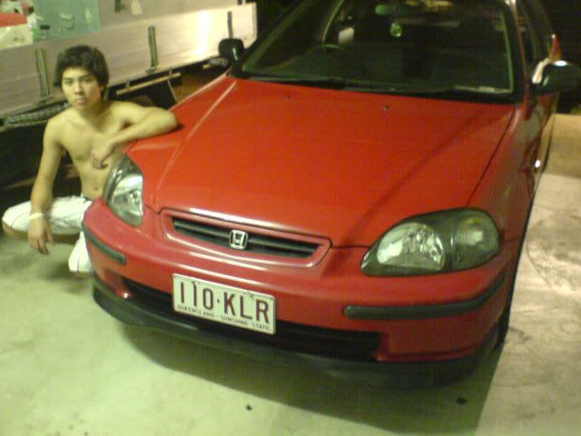

hey i just finish doing mine ones :D so far turned out good once they on the car i take some pic and post them up..

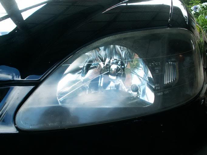

A friend and I tryed it today since we were bored.

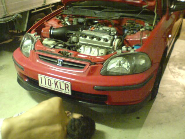

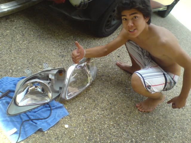

Original Headlight
http://i145.photobucket.com/albums/r...y/DSC00054.jpg

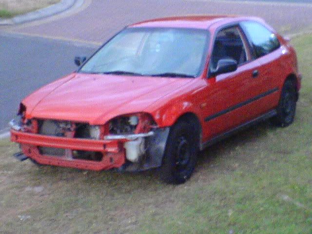

Bumper & Headlights Off
http://i145.photobucket.com/albums/r...y/DSC00062.jpg

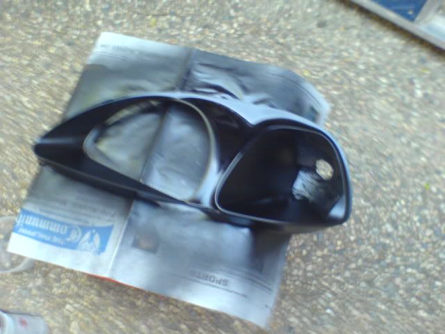

Hours Later...... Success!
http://i145.photobucket.com/albums/r...y/DSC00055.jpg

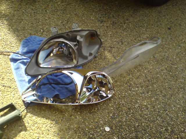

Chrome </3:
http://i145.photobucket.com/albums/r...y/DSC00056.jpg

Not bad for two 16 year olds eh.
Thanks again for the tutorial.
Sexy sexy ek9 head lightss!
