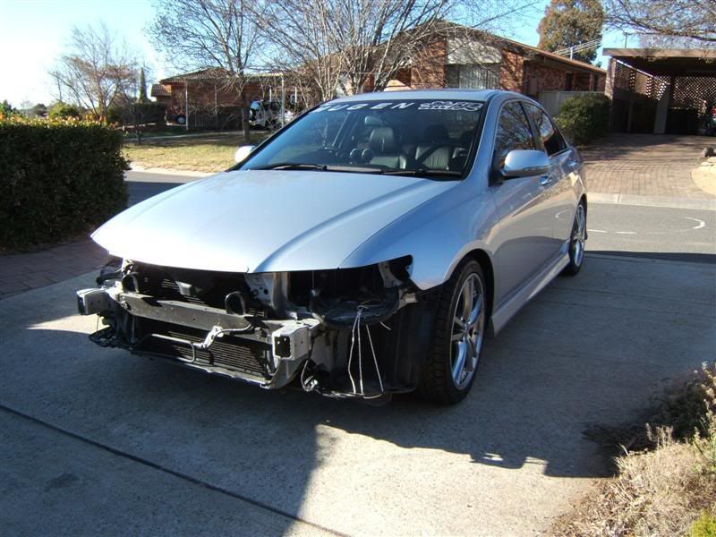

hehe got bored of waiting for my parts to arrive, so i decided id take my front bumper off so its easier getting the car on and off jacks and stuff... then it got me thinking... and this is what came of that thinking :p
http://i239.photobucket.com/albums/f...2115Medium.jpg
I still stand by my theory that the k24a is out of breath above 5000rpm, so it would be interesting to see your dyno results. Can't wait! :thumbsup:

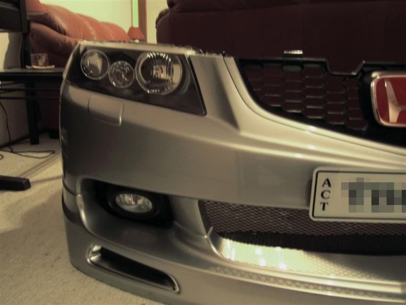

and blacked out the parking lights panel, and sprayed the whole reflector housing matt black, except for three chrome rings :)
heres some photos for those of you that dont know your euros well enough :p
BEFORE
http://i239.photobucket.com/albums/f...003/Before.jpg
HALFWAY
http://i239.photobucket.com/albums/f...03/Halfway.jpg
AFTER
http://i239.photobucket.com/albums/f...r003/After.jpg

pics of black headlight housings !
mmm full of 3" goodness lol
http://i239.photobucket.com/albums/f...2112Medium.jpg
http://i239.photobucket.com/albums/f...2114Medium.jpg
:thumbsup::thumbsup:
i mean pic with them on car :P
haha i notice it now that you mention it :P its a subtle change :thumbsup:
lol its funny that no one noticed, i was looking at first going thats an extreme weight saving move take of your headlights?! but now that you point out the diffrence looks very nice :thumbsup:
how much does the euro weigh?
On the headlight thing whats the difference between stock headlights and the one you have above?
Is it like this one? http://cgi.ebay.com/ebaymotors/Parts...=p4506.c0.m245
nope not like that one...
that one has the clear indicator lens... but i just removed mine (using chrome/orange globes)...
notice how my reflector housing is black... theirs is chrome...
vs.
http://www.stylishautoparts.com/head..._tsx04jmks.jpg
