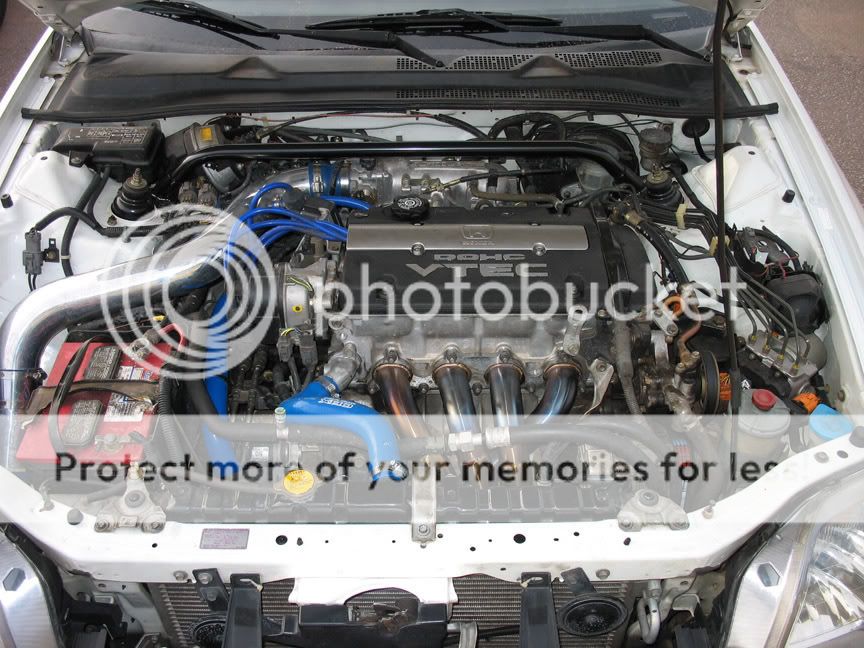

http://i351.photobucket.com/albums/q...enginebay2.jpg

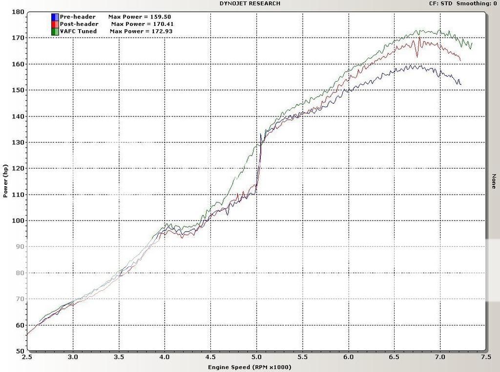

Here are the results of this header.
Car: Mine, duh
Mods: eBay CAI w/ K&N, Carsound universal high-flow cat, custom 2.5" crush-bent exhaust, OBX muffler (2.5" In/Dual 3.0" Out)
Temp: 66ºF
Hum: 6%
http://i351.photobucket.com/albums/q...AFCTunedHP.jpg

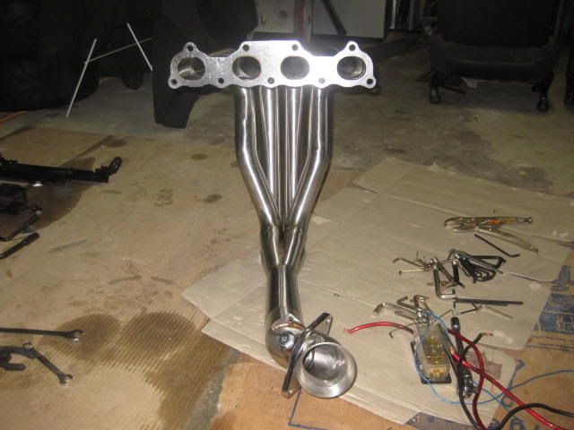

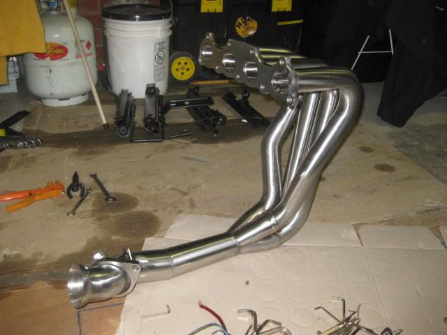

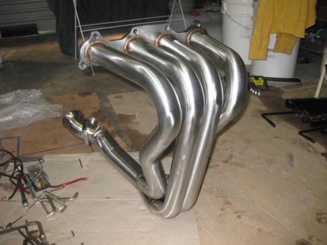

This is the same header as what Lukather has in prelude... alot of the guys on preludepower.com are running this header with great results and no problems so far.. I for one have spent alot of money on my genuine Mugen header and the power gains were no where near what i would have wanted for the amount of money i spent.
Lukather just a question: how is the fitment of the header you bought? did you have to notch abit of your crossmember? a few guys in the states needed to notch their crossmember for it to fit.
