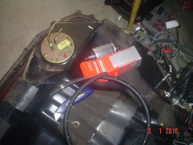

ah yeah thats similar... When I get my half cut ill that the efi harness then wouldn't I? Ill try find a wiring harness for the pump.

the engine loom is only a small part of what you need for the EFI conversion. Still need the loom that goes to the ECU, underdash fuse panel and then of course to the fuel pump.
unless you are an auto sparky or know someone who is that will work for free, trying to convert a carby harness to EFI will be a massive, massive task
