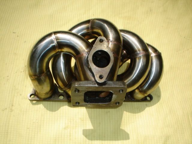

Guys I bought this exact kit off ebay for my B series almost 2 yrs ago and its been running on my car since then. But i can tell you now anyone even thinking about buying this kit it will not be a Permanent thing. This kit will only help you start a turbo conversion along the way over the next two yrs you will need to replace parts. Finally after two yrs I have replaced everything, the only thing left i needed to change was Exhaust manifold and turbo which i will most probably complete This afternoon (gt28rs here we come)
If i was to do it all again. I would have bought this kit, sold the turbo online Brand new. straight away would have bought a GT28/GT28RS/GR2871R got a Exhaust shop to re weld + reinforce the xs manifold and it would have lasted 2 yrs without any problems.

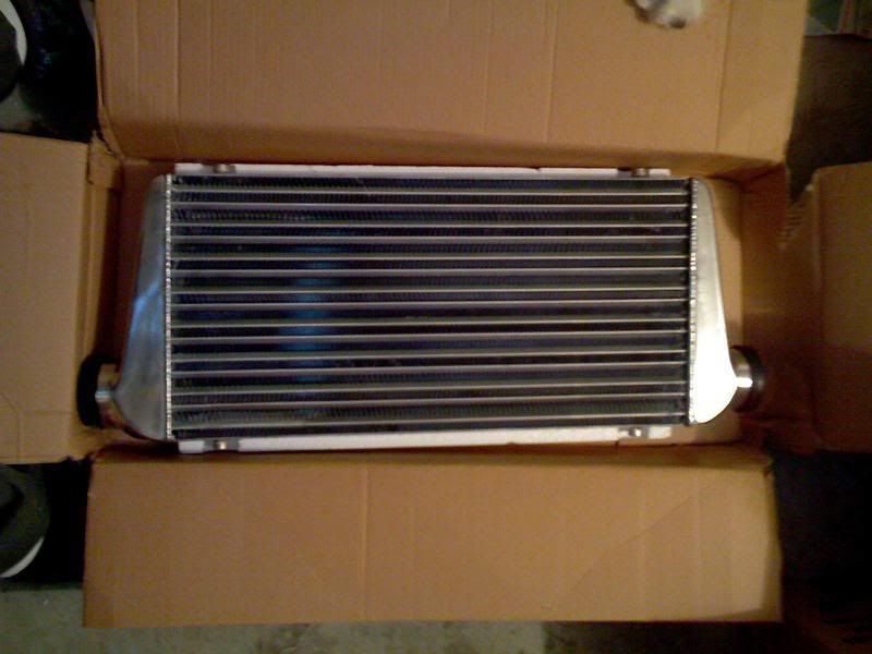

Also few other things are... This inter cooler that comes with the kit in the pictures is too small, you think it will do the job but it wont.I had this cooler on my car and Intake air on this cooler gave me about 49 degree's average. i got my new one on now which u can see in the Avatar and it dropped it to 29 degree's average. Which is a Huge fekin drop...

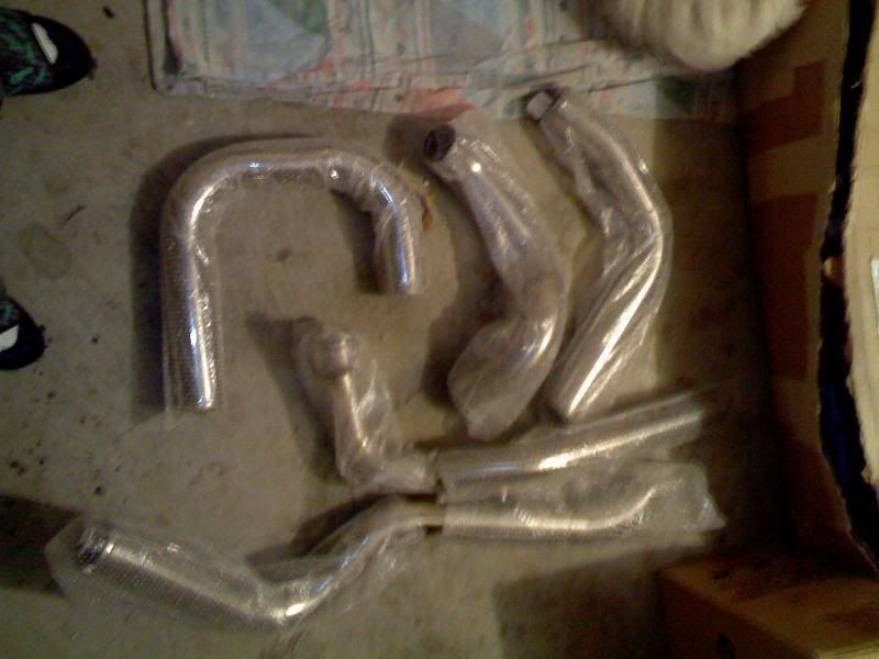

Another thing the Blue Silicone Cooler connectors aren't as strong as they look when u first buy them. they deteriorate very easily.
As i have told people on here before i think this kit is great and isnt as bad as people think it is. When i bought my kit for 1300 delivered the only thing that didn't work straight off was the BOV as it was leaking otherwise everything worked great for almost 6 months. Deffinatly taught me heaps about turboin cars i can tell u that. But i think for reliability reasons and now that i have the cash i most probably would have gone for a Greddy kit or i would have put together a kit from scratch. Back then i had a few spare dollars and thought it was fun to put a turbo kit on my car but really over the last few yrs ive had alot of times the car has come off the road because of the STUPID EXHAUST MANIFOLD FAILING!! FFS sorry bit of a vent.
