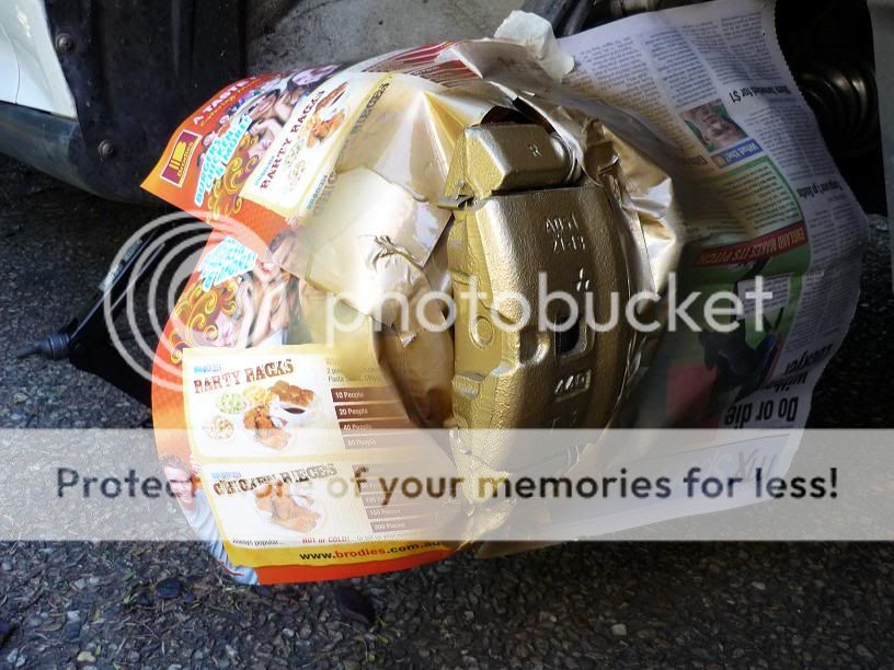

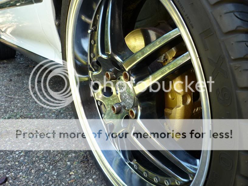

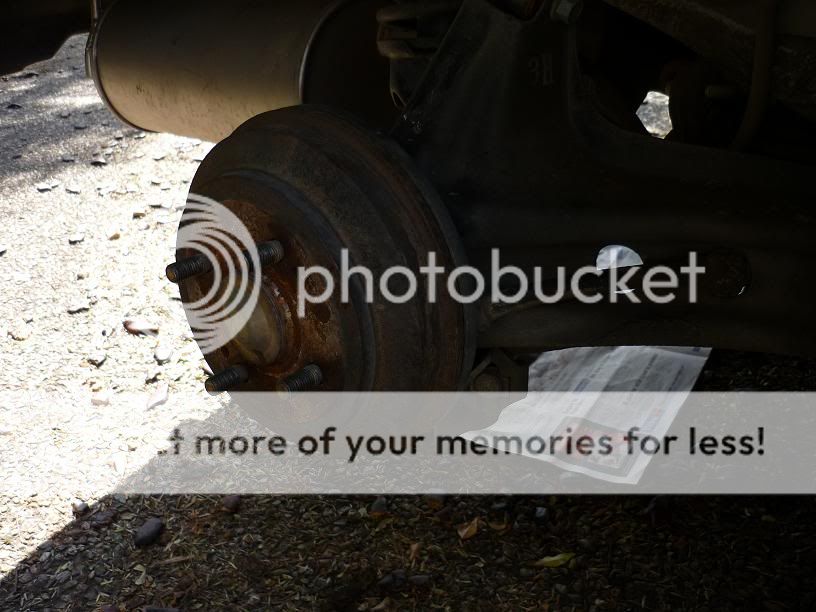

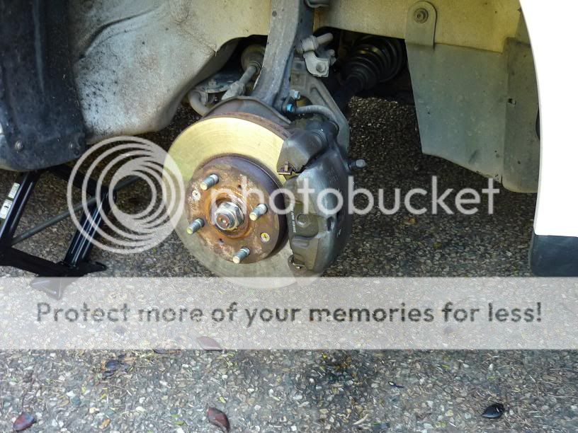

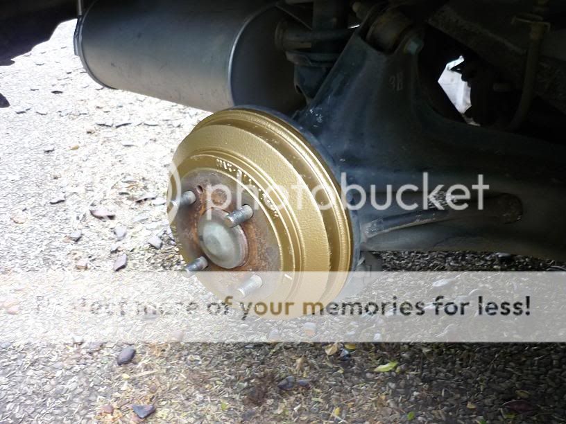

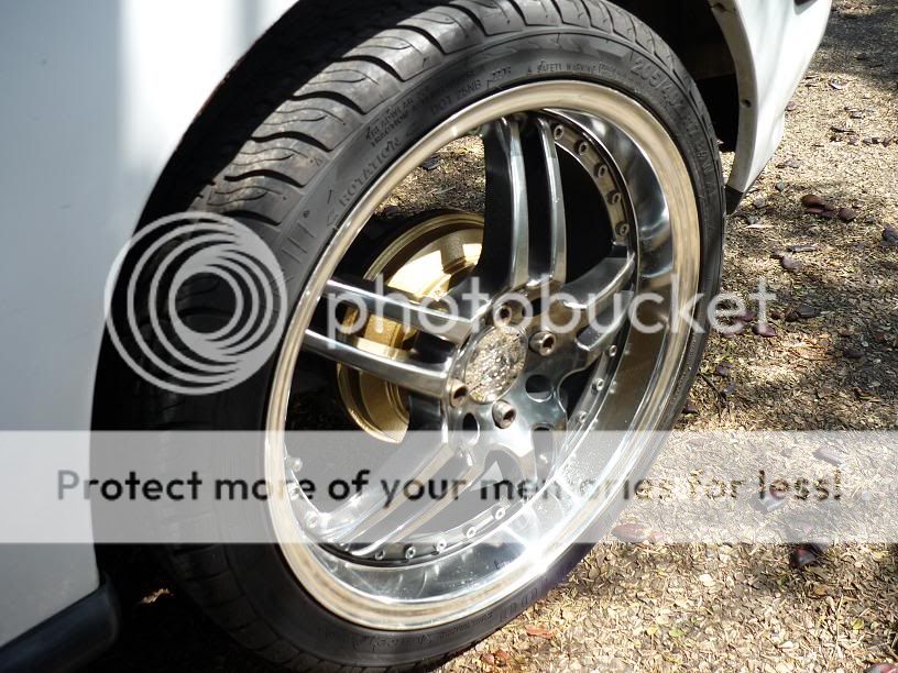

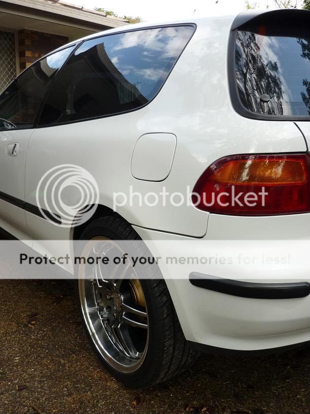

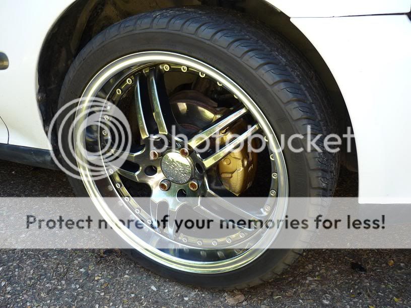

today I painted my brake calipers and rear drums...
unfortunately my personalised plates were colour coded to another car so I painted them gold so the numberplate doesn't look odd... lol
http://i489.photobucket.com/albums/r...i/P1020002.jpghttp://i489.photobucket.com/albums/r...i/P1020008.jpg
http://i489.photobucket.com/albums/r...i/P1020011.jpghttp://i489.photobucket.com/albums/r...i/P1020009.jpg
http://i489.photobucket.com/albums/r...i/P1020016.jpghttp://i489.photobucket.com/albums/r...i/P1020018.jpg
http://i489.photobucket.com/albums/r...i/P1020022.jpghttp://i489.photobucket.com/albums/r...i/P1020014.jpg
Short ram air intake with pod filter and magnaflow exhaust on order...
damn man that looks good, suits the car!
i was a bit iffy about the gold at first... but wanted to do something different because everyone goes for the "go fast" colours... red is really over done... so classy yet a little flashy and doesn't attract TOO much attention...
I like it. Love the gold. So much nicer than the red IMO :)
What brand did you use? Did you do primer and clear?
What headers did you use Bobby? They look awesome! ;)
no primer... just 4 coats... and i used VHT Caliper paint... $16.95 @ Auto Barn...
used a wire brush to scrub the outside and sprayed it with K&H Wax and grease remover (degreaser solvent - quick dry), then used the heat gun on it to make sure it was 100% dry... after that just 4 light coats of the VHT Caliper Paint... the longest part was waiting for each coat to touch dry 100% before putting the next coat on... about 10 mins in between each coat...

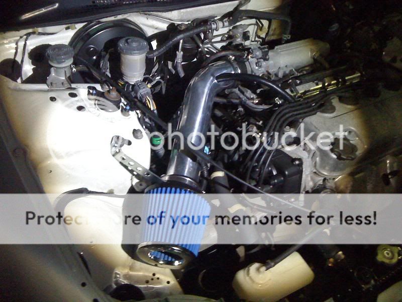

last night after work with the assistance of a mate we installed my Simota short ram air intake and pod filter... sounds nice...
http://i489.photobucket.com/albums/r...SRAIandPod.jpg
4" cannon exhaust going on tomorrow :cool::thumbsup:
nice.. be careful buddy thats defect unless you can make a cover for it which im gonna do this weekend aswell. get some headers and youll be set will sound even better.
I'm hopefully selling my EK this afternoon :D
drain the oil in the sump, and started it up, no excuses for motor swap
yeah, did that last night, and went straight out and bought a heat sheild this morning for it... its all legal now :D
CBF taking photos of it right now because it was a real tricky piece of work getting it in with the bracket and all the rest of it... lol... on that note, the power gain is noticable on a D-Series engine... had a turbo-charged subaru outback with a nice exhaust on it give me a run at a set of lights... but i stopped trying at 60km/h because i'm good lil boy ;)
All depends on the policeman unfortunately... A mate of mine had CAI setup, pod down inside the front bar and they still put it down as a defect. simply because it wasn't stock.... They can pretty much defect anything they want to be honest.... Meh, don't worry about it man, the sound and slight power increase are worth the tiny risk :thumbsup:
Not sure where Healesville is (NSW / Sydney i'm guessing), but in QLD they generally don't cause too much issue with things like this... the only time they go thru ur car with a fine tooth comb is if ur acting like a complete twat and deserve to get defected... with all the hooning laws up here its hard for ppl doing dodgy stuff to get away with it anymore... as long as the car isn't slammed to the shit-house and looks respectable and ur not driving ridiculously they'll leave u alone... exposed they'll put on a turn, but the if its covered by at least a heat sheild they don't worry... still got all the stock parts handy anyway just incase ;)

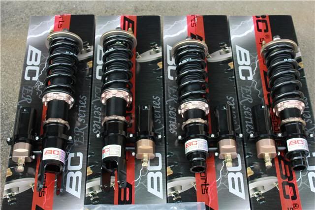

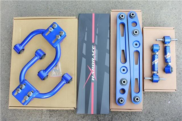

didnt do it 2day but put these on yesterday.
http://i204.photobucket.com/albums/b...84_640x427.jpg
http://i204.photobucket.com/albums/b...83_640x427.jpg
Hey man let me know how the BCs treat you as im looking into buying a set soon. Cheers
there great i also have them on my ES and they are awesome, been thru many track days.
i took it for a drive last nite and all was set on 0 and it felt awesome, it stiffened up the car alot and took all the roll out. i also changed the spring rate when i ordered them so these are a bit stiffer then the usual EK spring you get with them.
the EK is a track only car.
what are the spring rate for BC? Just curious as im wanting to buy these in the near future....
Isnt the Ek9's running some where around 8-9kg/mm factory? so these coilovers would some what needa be around 10-12kg/mm to put perform ek9 suspension right
i think when ordering BC, you can specify what spring rates you want. 12F 10R sounds good :D but you have to put up with the harsh ride lols
yes like eekayfour said when u order BC u can specify what spring rates u want. i choose the 12f 10R, as per what its suppose to be 12/6, which is really off if u ask me.
Hardrace stuff is AWESOME!! i am rockin there Spherical trailing arm bushing. spot on gear. Not sure on those BC's to be honest, but then i haven't tryed them so i can't say much. They just seem to remind me of all the rest of the generic coil over brands eg. D2, HSD, K-sport etc. Can't wait to be out on the track with you and your EK mate :thumbsup:
yea 12/6 sounds abit uneven, hmmm, 12/10 sounds like the good combo :)
Harsh rides are what makes the experience for coilovers better, lol
