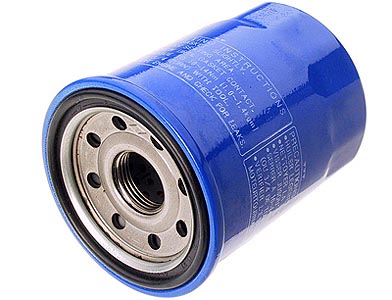

for sure piece of mind. Problem here tho is the internet and how its interpreted......
"hand tight" to you sounds like alittle bit tight / finger tight.
To me and most its as I mentioned earlier - as much as possible by hand !
but yes better safe than sorry. BE CAREFUL tightening a oil filter after a drive - it will be HOT and also you can easily thread it / over tighten as the metal has softened with heat. I advise to wait till the car is cool again , clean the oil filter and retighten / nip up slightly if need be
