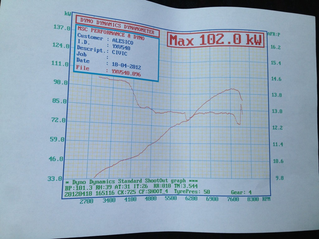

Got the pic of the full sheet with rates and figures below it??
Attachment 21717B16a2
Std bore
Std displacement
Std stroke
Brian crower stage 2 cams
Brian crower cam gears
Brian crower valve train upgrade.
Xforce full system
Carbon whale penis
Cams advanced 4 degree intake and exhaust
Hondata s300v2
103 kwatw
Drives well smooth right through the rev range
Yep, looks good on std shootout mode so no overinflating there, solid.

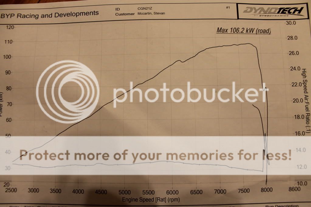

Engine - B18C2
Displacement - 1.8
Bore - standard
Stroke - standard
CR - standard
Camshaft - standard
Camgear Settings - standard
VTEC X-Over -standard
Gearbox - Type R 4.7 gearbox
I/H/E - Pod filter and spoon catback
ECU - standard
http://i814.photobucket.com/albums/z...IMG_1153-1.jpg
very nice figures for pretty much stock seems like a healthy engine
200XXX kms pretty proud of it i installed plm headers this weekend ill go bak and see what the difference is
