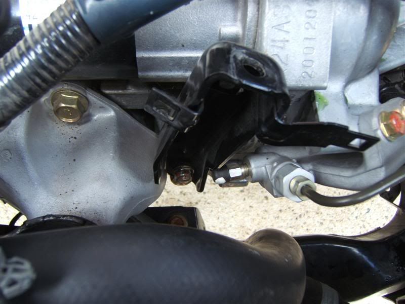

How did you manage to fit your hand beneath the stock intake manifold to get at the support bracket? I can't fit my hand in at all.
lol please dont talk about that support bracket... i hate that thing! lol and im pretty sure everyone else with an RBC now hates that thing lol...
just alot of squirming, trying different angles, coming up from below....

The support bracket lean over from the left hand side of the car and you can slip your hand in from the left hand side of the radiator (passenger side) arch your arm towards the bracket use the 12mm socket wrench to undo the bolt.
i was going to undo the undercover but would have wasted too much time to jack car up so i found that way was more efficient.
lol my bracket is still sitting there... freakin bolt cross threaded or something... ive been meaning to remove it for weight reduction reasons :p
haha the culprate:
http://i239.photobucket.com/albums/f...1651Medium.jpg
ROFLMAO!!!
Bugger that sux, but hey at least you don't need to do much to replace your RBB.
When you removed your RBB, didnt you undo that bolt?
Cause i took the whole RBB + bracket together out.
Only thing i did under the chassis was attach the socket + extension.
Engine bay - slip hands in and attach wrench then undo.
LOL. My bro in law got that one off yesterday after some friggin around! Its a biatch alright.

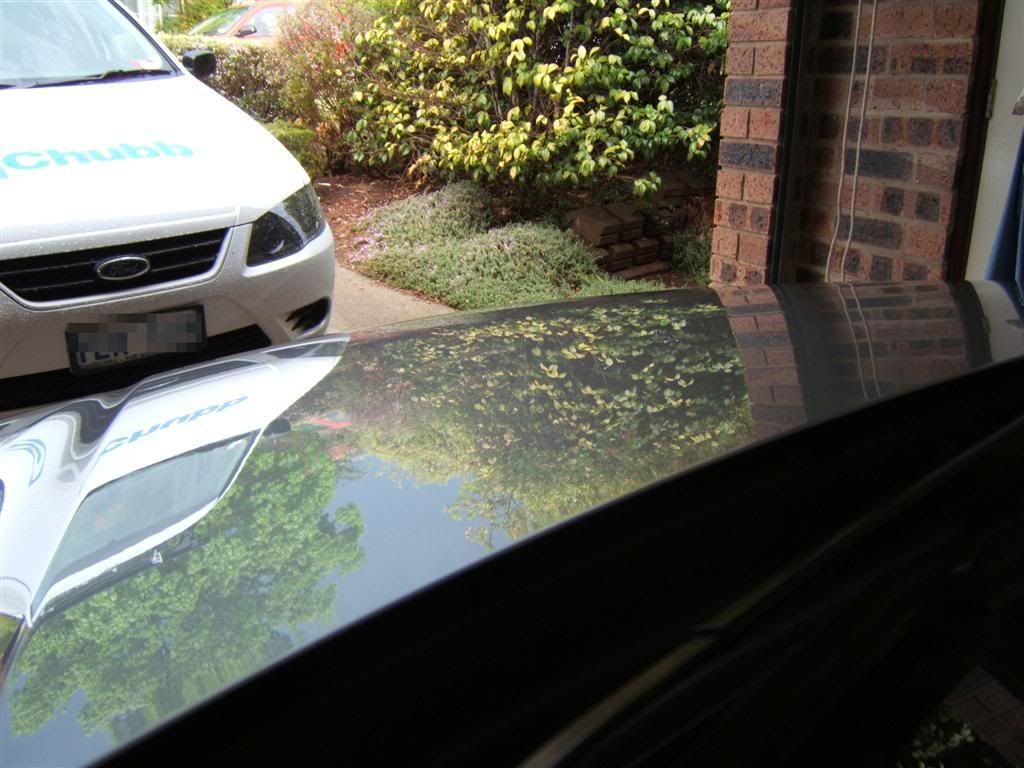

used meguars quickclay on my bonnet this afternoon... and damn it looks sexy! cant wait till i can do the whole car! heres just a quick snap shot...
http://i239.photobucket.com/albums/f...onnetLarge.jpg

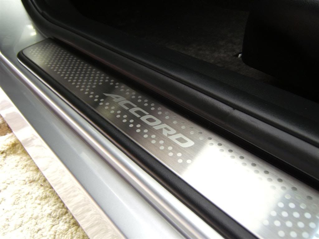

And also my Accord door sills arrived! (damn fast i might add! A+ to Heeltoe Automotive!)
Heres a quick pic, sorry about the quality, its dark in my garage and i cant drive the car out yet lol
http://i239.photobucket.com/albums/f...F2432Large.jpg

better pic of "Accord" door sills:
http://i239.photobucket.com/albums/f...F2454Large.jpg

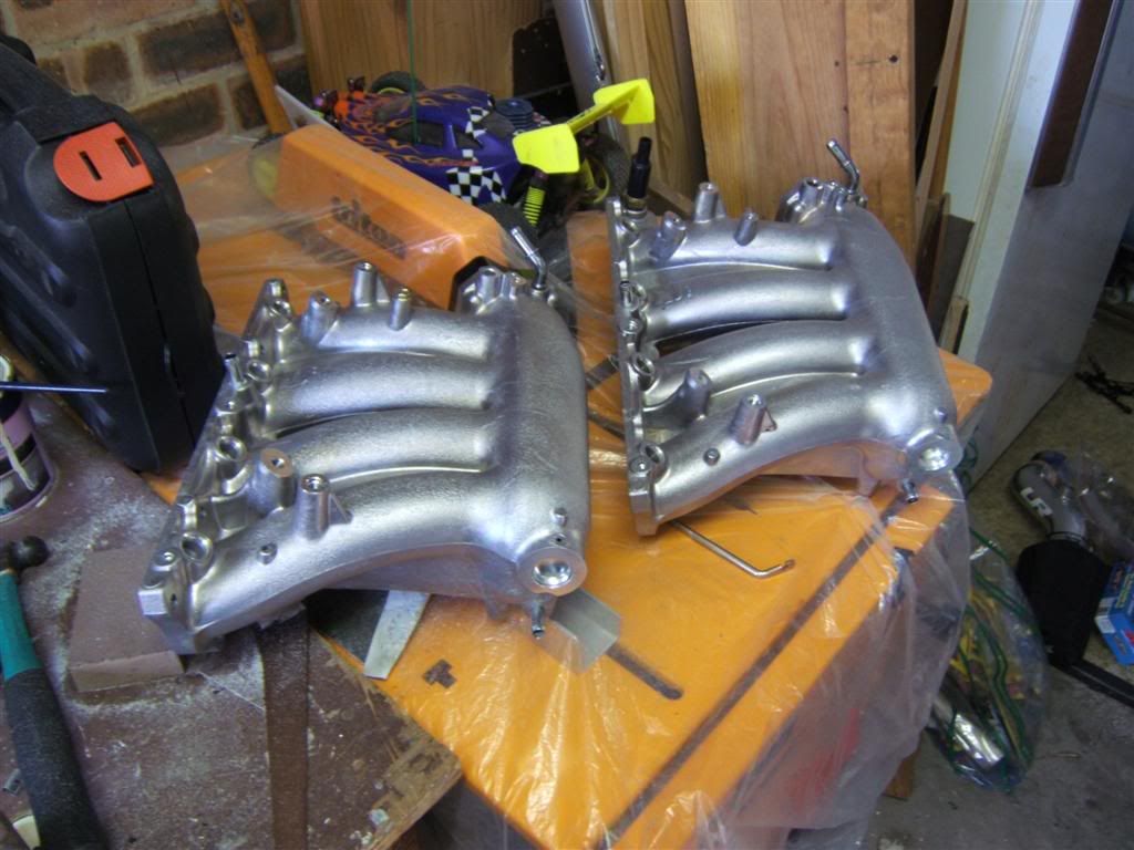

RBC's (yes plural):
http://i239.photobucket.com/albums/f...F2481Large.jpg
Port matching to 66mm P2R TB spacer for my J32A3 TB:
http://i239.photobucket.com/albums/f...F2485Large.jpg

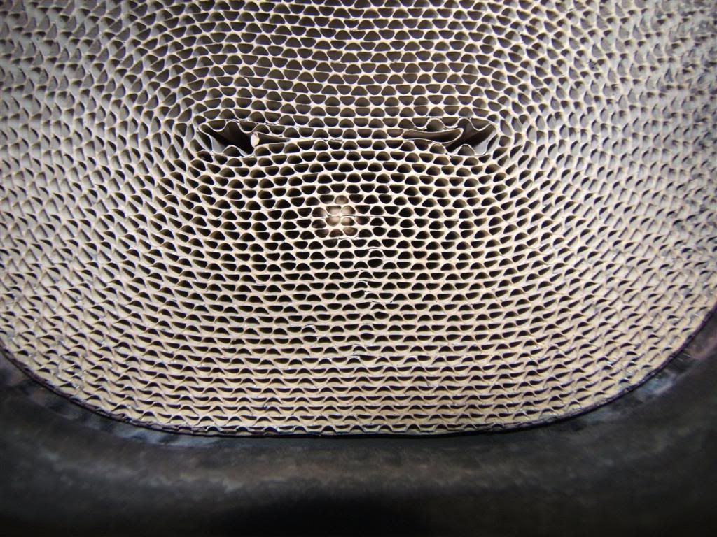

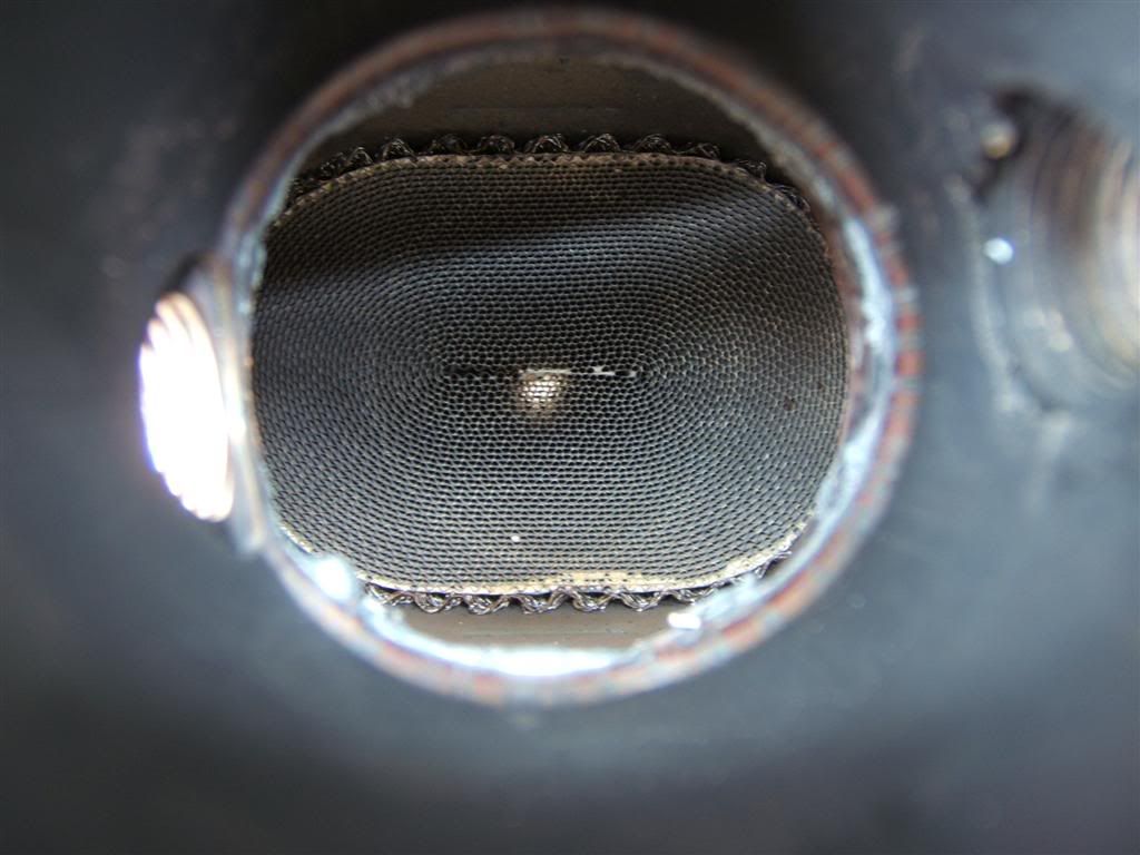

got my new magna flow cat welded in over the last few days... took some comparison pics... looking at my old cat (not sure on the brand) you can see why it broke loose and rattled (see pic below):
http://i239.photobucket.com/albums/f...F2458Large.jpg
whereas the magnaflow cat has a spongey padding around the film to hold it firmly in place (see below):
http://i239.photobucket.com/albums/f...F2462Large.jpg
