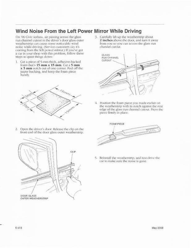

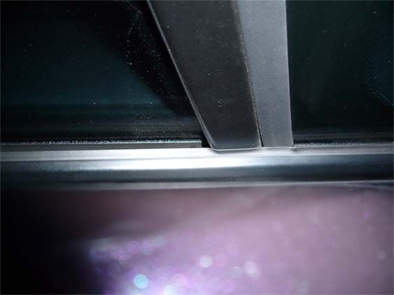

Wind noise from both front doors, suspected both front outer weather-strips
dealer forgot this one too... but i showed him where (in american civics) the wind noise comes from (may 2006 TSB) which is the gap between the outer weatherstrip on the front doors and the front window guides/post things... a civic in the showroom had no gap, but my car had >2mm gap so he's ordering in new ones for me.
