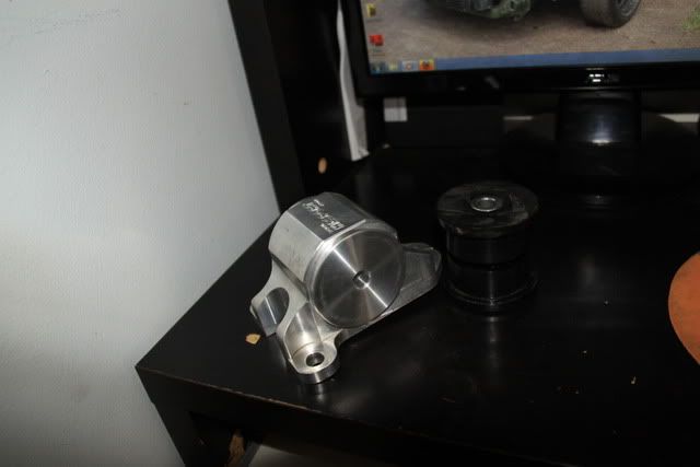

made up a solid mount rear mount and installed it
before
http://i405.photobucket.com/albums/p...7/IMG_2066.jpg

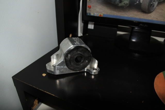

after
http://i405.photobucket.com/albums/p...7/IMG_2068.jpg

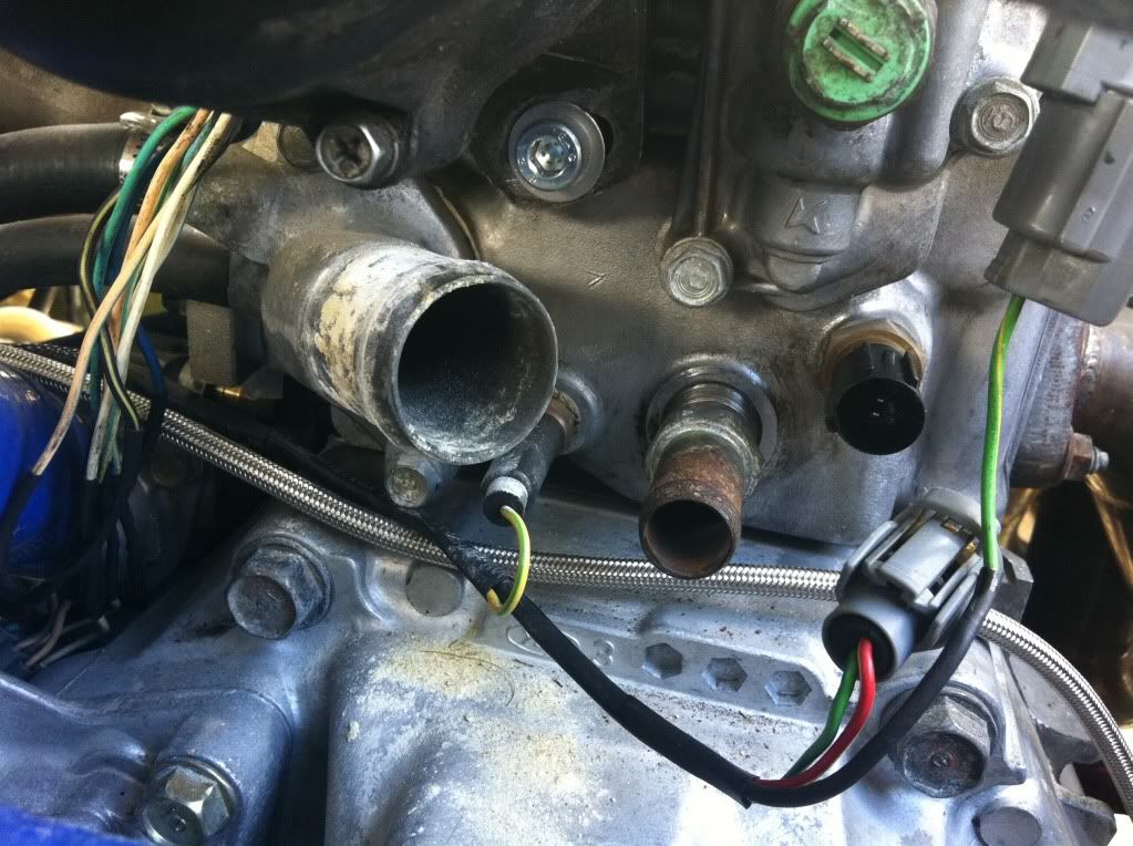

also purchased block off plugs to blank up the existing heater hoses from motor.

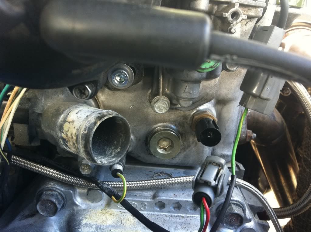

didnt have to buy them man could of went to wreakers or if u had spare head like me you can undo it and use it as the block off
Remove the water outlet in the the head (use a socket or ring spanner, not a shifter)
Replace water fitting with B-Series rocker shaft plug
-10mm allen drive found is 3 places on B-series vtec head - 2 cam belt end, 1 dissy end
These plugs share the same fine thread as the water outlet in the head so is/are a direct replacment that neatly solves the head side of the issue.
hey dave have you got pics? it was only 4 bucks but if it looks neater why not cheers
cheers dave that's heaps neater
i'll find a spare head or head off to wreckers and i'll find them bungs very neat thanks heaps,

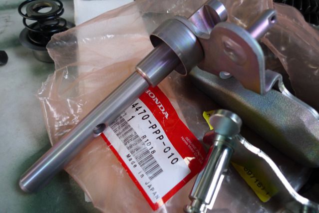

replaced shifter arm shaft, selector and mtec springs for dat crispiness
http://i3.photobucket.com/albums/y97...5/P1020572.jpg
http://i3.photobucket.com/albums/y97...5/P1020575.jpg
