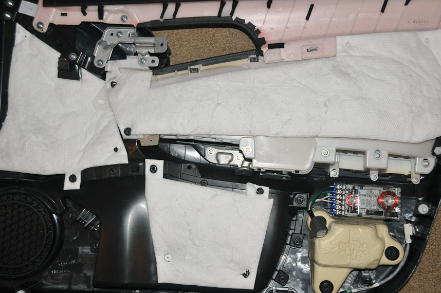

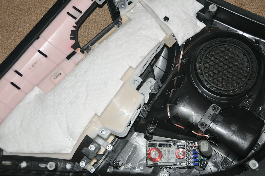

First, mounting the Focal 165VR Crossover in the rear door trim:

Mounting the Focal 165VR Crossover in the front door trim:
Attachment 15691

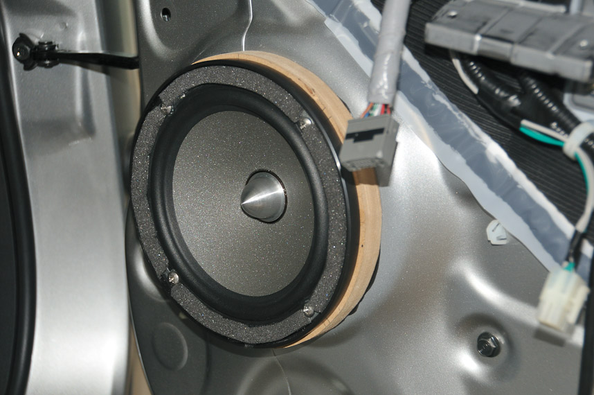

The 165VR woofer in the front door. 1x16mm + 1x12mm MDF spacers.
Attachment 15693

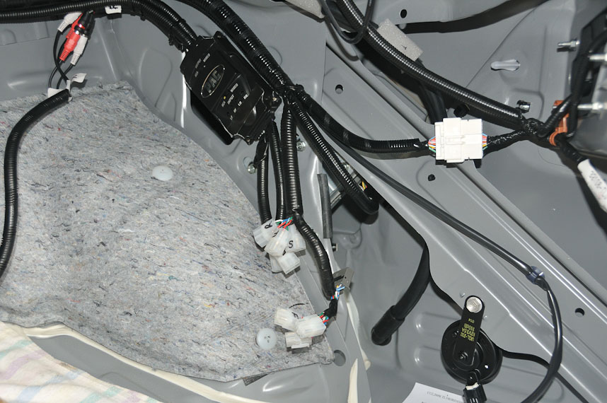

Splicing into the speaker output loom from the Panasonic amp. Speaker level inputs to the PAC SOEM-4 transformer based, DC coupled LOC and RCA outputs to the Focal amplifier.
Attachment 15696

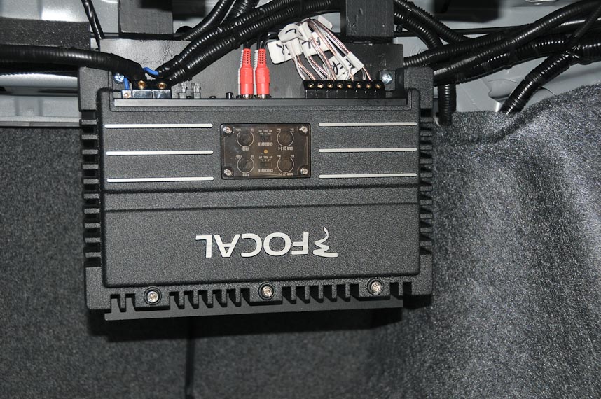

Finally the Focal Solid-4 Amplifier. I made a cradle which I mounted to the rear parcel shelf. The Amplifier is then mounted in the cradle which can be swung down for access to the controls and wiring. I've shown the amp in it's lowered position here.
Attachment 15701

After some questions on other aspects of the install I have added some additional photos of the door trims etc:
Extra trimming required for clearance of the Focal speaker at maximum extension.

Location of Crossover in front door trim.

Location of Crossover in rear door trim.
