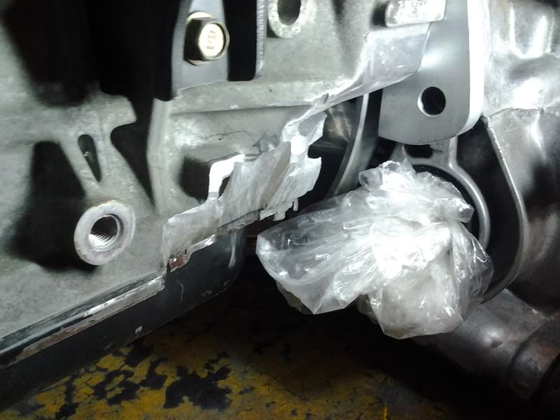

I've got the Avid mounts in my EG setup with a H22A. The engine has no tilt and no bonnet clearance issues. What it DOES have is clearance issues due to the height of the sump compared to a D or B series. Sit's further to the passenger side. Kit allows retention of PS and AC too if you want to keep the D series AC. Innovative bracket should do but you have to buy the CRX specific one. The EG one will not mate up with the CRX AC compressor. This might not be applicable as your car is a CRX, and most of my info pertains to owning an EG.
