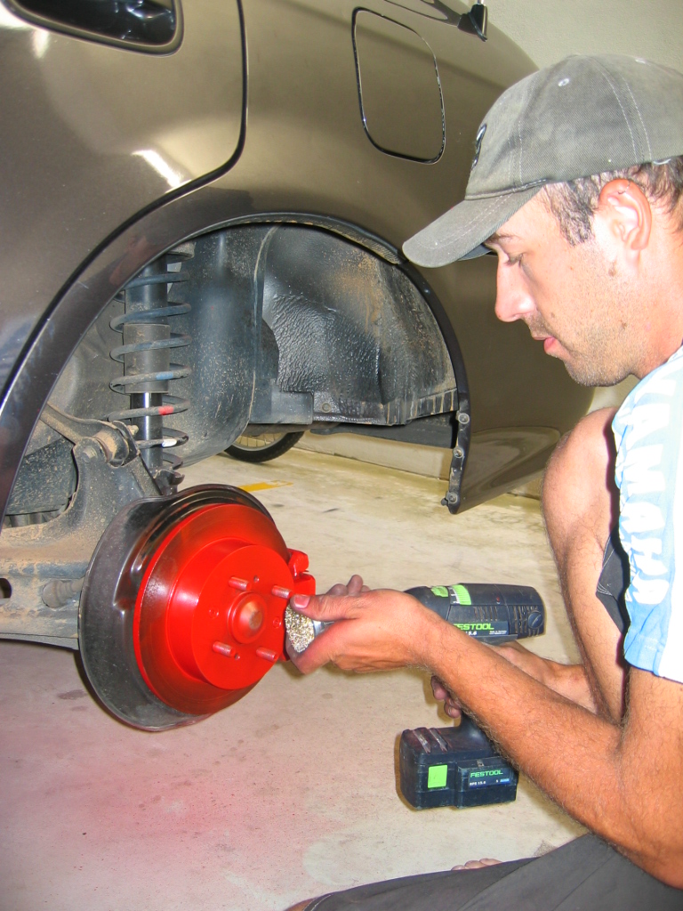

• Scrub the rust off the rotors
http://img112.imageshack.us/img112/4157/cimg0758ew2.jpg

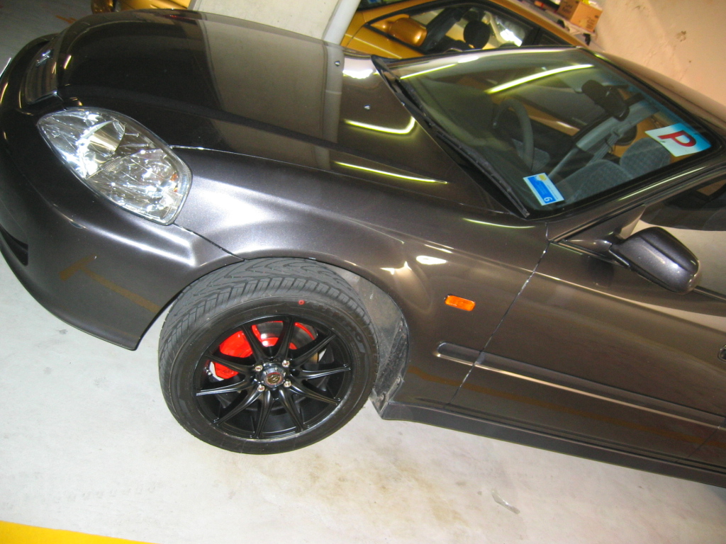

• And your done, apply clear coats if you can be stuffed. Put the rims back on and repeat the same steps on the other 3 calipers. If you get over sprays like I did, just colour in with a black marker afterwards it should do the trick.
