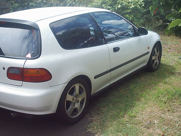

1 - Its a good idea to park your front wheel on a strip of grass if you can to avoid dry steering.

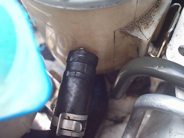

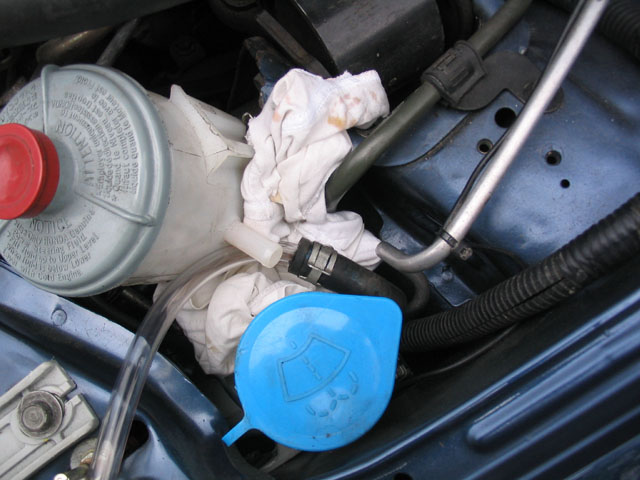

2a - Locate the power steering reservoir there should be a hose entering the side of tank. This is called the 'return hose'.
2b - Use the pliers to undo the clamp and remove the hose (keep a rag handy to catch/wipe up any spillage), and pull the tank up out of the mount.

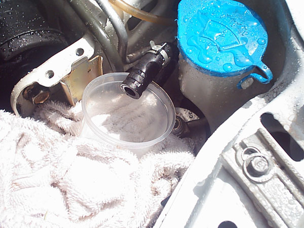

3 - Remove the tank out of the bay and place the catch-container under the return hose. I used an old towel to avoid as much spillage as possible.
4 - Start the engine and let it run on idle. This will cause the fluid to run out of the hose into the catch-container.

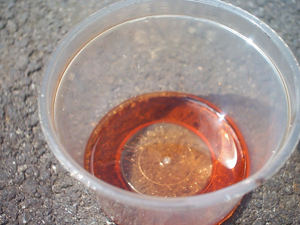

5 Turn the steering wheel to full lock both sides, several times. Once fluid has stopped running into the container, turn off the engine. NB Turning the wheel will be very hard, as effectively there is no power steering.
