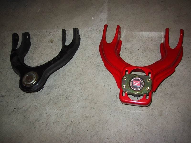

Here is what a camber kit looks like:
http://img472.imageshack.us/img472/5...tcamberhd3.jpg
The metal silver piece (the ball joint) is adjustable so that it slides back and forth (therefore adjusting the camber). On either end of the metal piece are two bolts that lock the camber angle in place. One of the main problems identified with this design is that the channels that the bolts sit in are made of only a small amount of metal and have been known to bend or break. Skunk2 released a revision to their kit which now tries to stiffen up the area and stop the ball joint ripping out.
This thread was just to bring awareness to you all about the kits on the market and to research them well before committing. I have attached some links below to show some real world examples:
