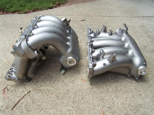

i think its the same as the euro R, i know its different to the K20 manifold off the S2K and ADM DC5, they use a more snail like intake... yes the shorter track will lose power low down, but it gains up to 7hp top end... and when used in conjunction with CAI, headers, and reflash, they obtained about 15hp gain... it'll also give me more room to move when it comes to cams and headwork...
you can see below the intake tract on the RBC is actually about the same length as the PRB, but doesnt snail around, allowing for free'r flowing air :)Quote:

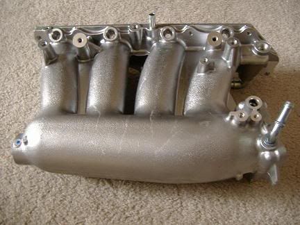

YAY! got my RBC intake manifold...
everything seems the same (fittings wise) except for what i think is the idle control solonoid? (anyone confirm) its a small vacuum line that comes out of the bottom of the plenum on the RBB manifold... and its not on the RBC... so ill just tap into the plenum myself :)
ill post pics and DIY once installed :p

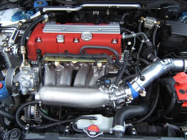

INSTALL IS IN PROGRESS!!!
Already removed RBB manifold (what an absolute bitch that was!) now just popping down to the shops to get some unexpected parts! :(
will post updates as soon as finished :p
EDIT:
RBC intake installed, just finalising wiring loom, vacuum lines, coolant, and EVAP...
UPDATE: primed fuel pump, fuel started spraying all over the shop! f*cken fuel rail o-ring cracked :(
http://i239.photobucket.com/albums/f...F1668Small.jpg
INSTALLED!!!
but not driveable atm... ill need to go to honda tomoz and get new fuel connecter o-ring :(

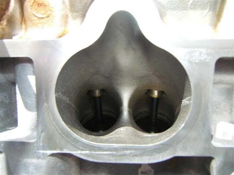

I forgot i took this pic, it shows just how good modern day casting is, i cant see porting getting much more power (if any) off the k-series
http://i239.photobucket.com/albums/f...1637Medium.jpg

weather permitting ill have pics of my complete "euroR" engine bay online tomorrow night :p
