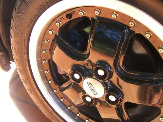

Finished Product
http://i209.photobucket.com/albums/b...r/RIMG0051.jpg
Try this yourself, it's really quick and simple. No more time wasted to tape up wheels with newspapers! :thumbsup:
