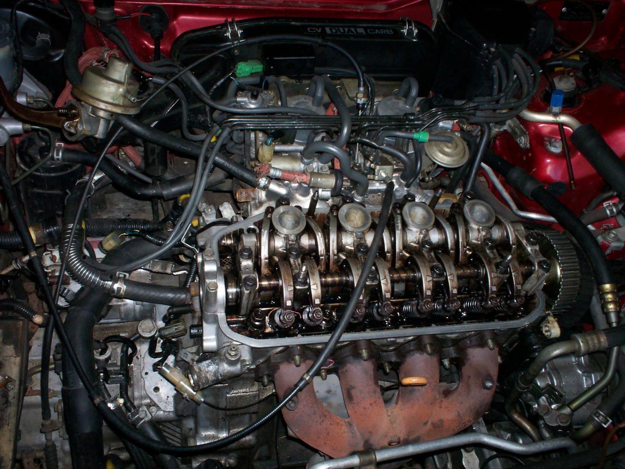

    this is where i am up too atm can't get the middle bolt off the intake manfold got to get a tool i talk on msn ok

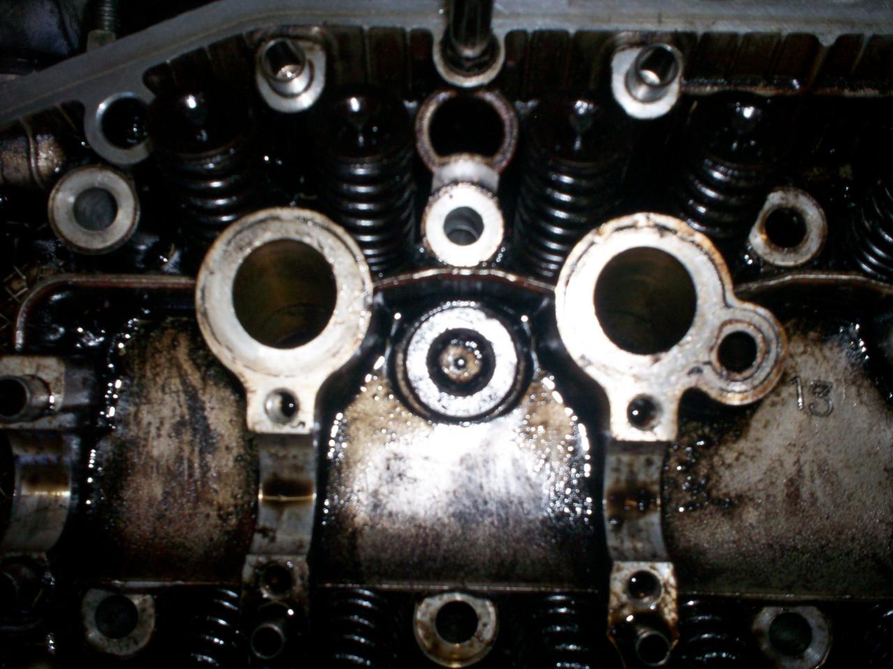

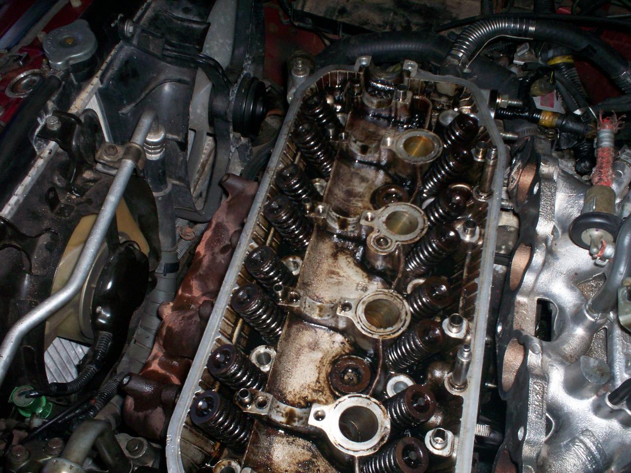

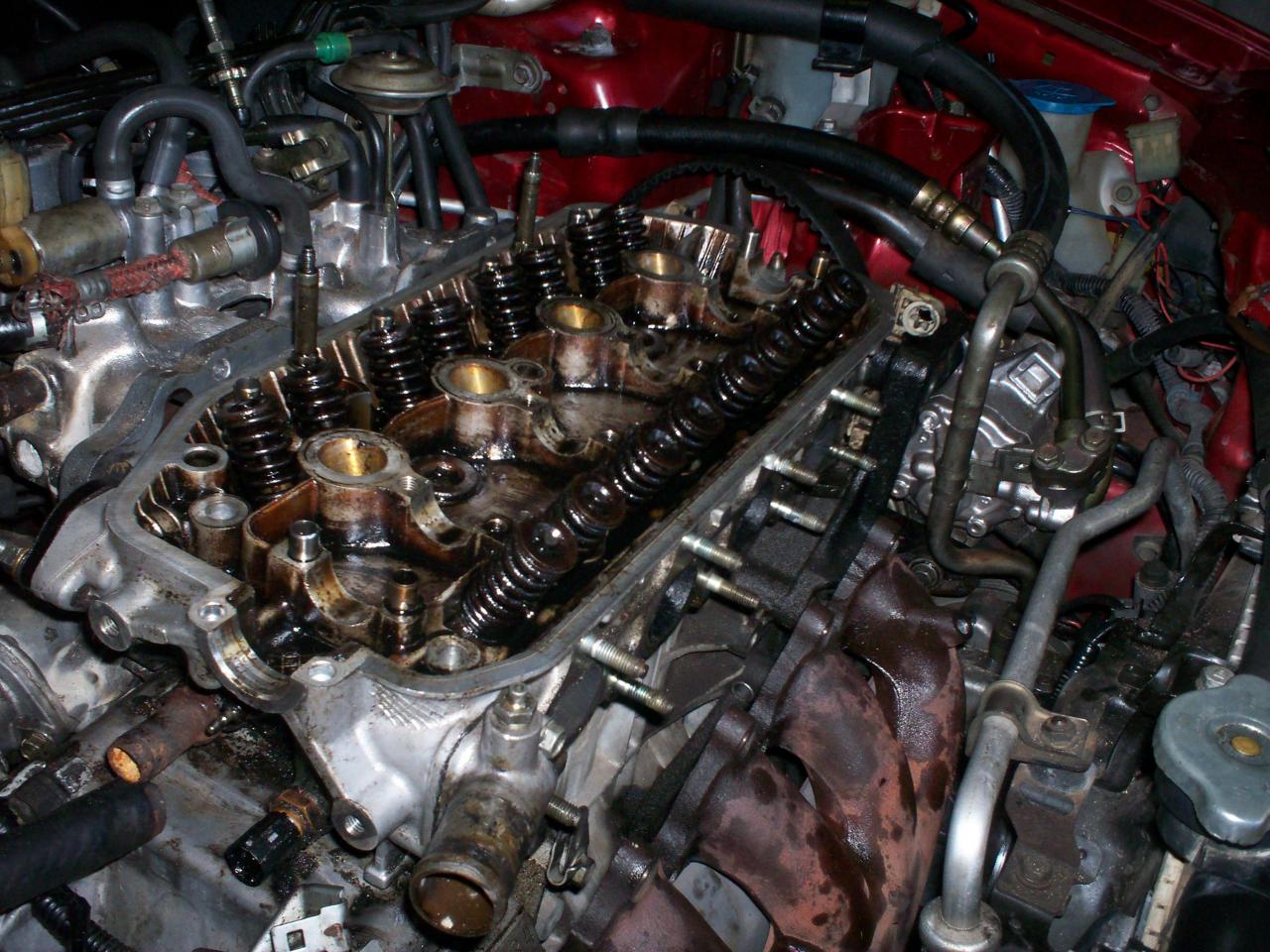

    got that middle bolt off the intake manfold but still can't get the head off and i got the cams off too do you know what this bolt is see pic

    The only thing that attached the head to the block are the head studs. More than likely, the old head gasket is keeping them together. Be careful if you try and pry them apart that you don't mess up the mating surfaces, they dent real easy being alloy.
