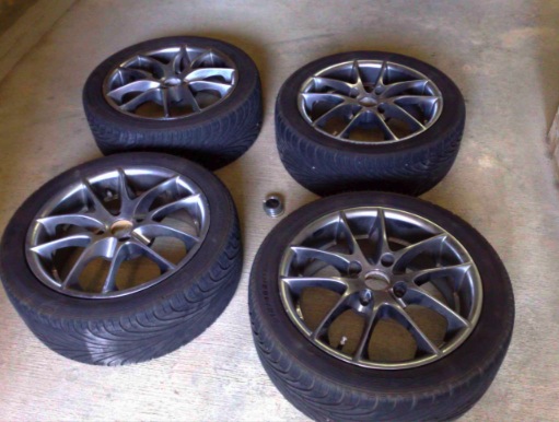

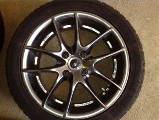

    hey guys got some rims roh 4 stud of a mate for my 1994 Honda accord vti and they dont fit, they look awesome . is their any way i can get them 2 fit with out spending a lot of money. its cause the studs on my car are 2 far apart for the studs on the wheel . so they dnt line up. sum-thing lie a wheel spacer and what would i type in or does anyone have one for if their not able 2 fit or mad able 2 fit i have 4 rims 2 sell with 90 percent tread bit of gutter rash 17 inch 4 stud rims, of a Honda jazz.

    if the rims was from a jazz (4x100) then it wont fit on an accord (4x114.3)
    you'll need to look for wheels from S13, 180SX, R32 non GTR, R31, Mitsubishi Colt, JDM ITR, older Prelude - all these share the same patterns as accord...
