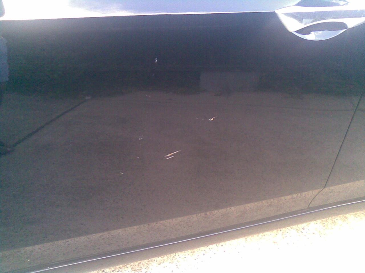

    I had my new black euro parked in a shopping centre and some idiot left some scratch marks on my left front door. Most probably, it was someone swinging open their door without any care for other cars whatsoever. Left door has 2-3 scratch marks where paint has come off and running nail through also clicks which may be means simply polishing and buffinn won't do the job. Any advice on the fix will be much appreciated. I did take a couple of qoutes but one was for $600 and other one for $ 350. Scratches are two few and too small in size..not more than an inch long and without any dents.. I am also attaching a couple of pix for referance....Any advice!!!!

    For ose sort of small sizd marks, I'd apply touchup paint using a toothpick.

    thanks aaronng, where to find touchup paint from and a DIY would do? or to be safe, getting done by professional?
    Go to your your nearest Honda Dealer Parts Dept. Ask for the Paint Touch-Up Pen. Paint Code should be on a sticker on the left had side front passenger aft frame near the door lock.
