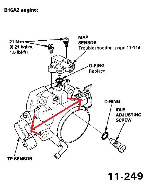

If you have been reading my other thread regarding hunting idle (b16a) I think I may have found the problem, my standard TB has slight play where the butterfly is secured which will probably be letting a little air in, which could be causing the hunting.
