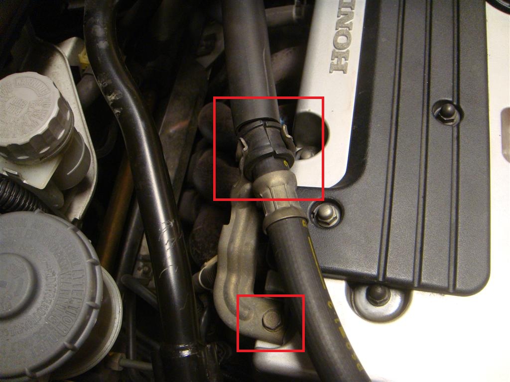

    1. Remove the hose from the bracket and loosen the bolt with a 10mm socket to remove the bracket

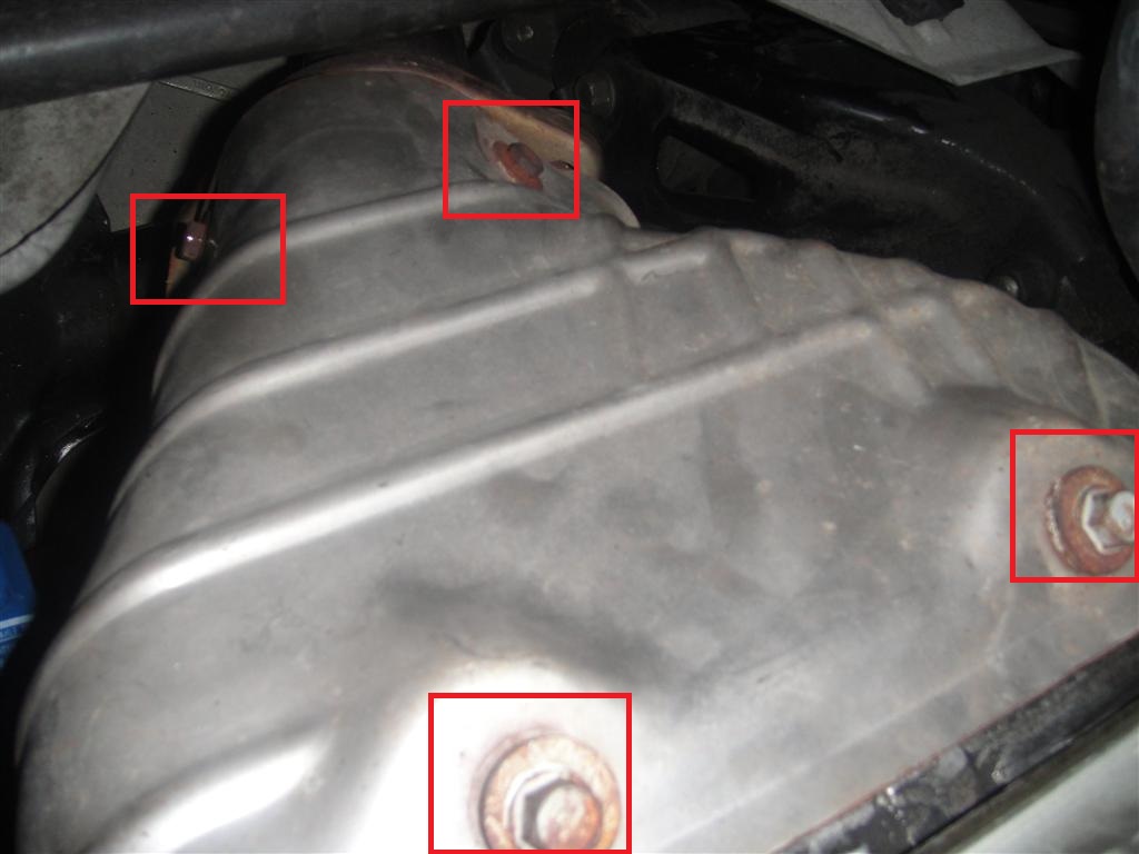

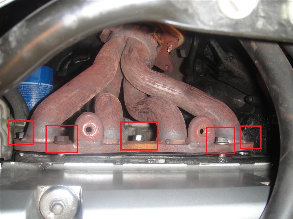

    2. Loosen the 5 bolts/nuts (top 2 are nuts, bottom three are bolts) displayed using a 14mm socket.

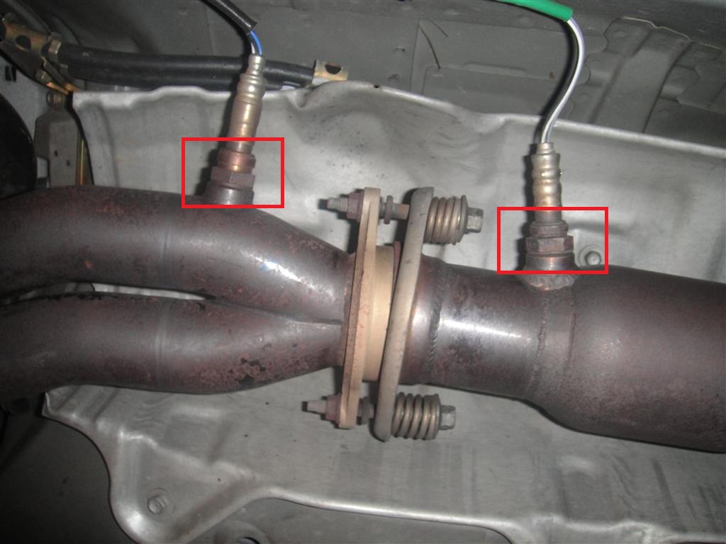

    3. Remove the front wheels:
    a. Put a wheel chock behind the rear wheels and ensure the handbrake is on.
    b. Loosen the wheel lugnuts and jack up the car. Place a jackstand at each side of the car and lower the car onto the jackstand. (I kept the hydraulic jack at the front of the car for additional support however most of the cars weight is on the jackstands - there is not much of the cars weight on the jack).
    c. Remove the lugnuts and take of the wheels

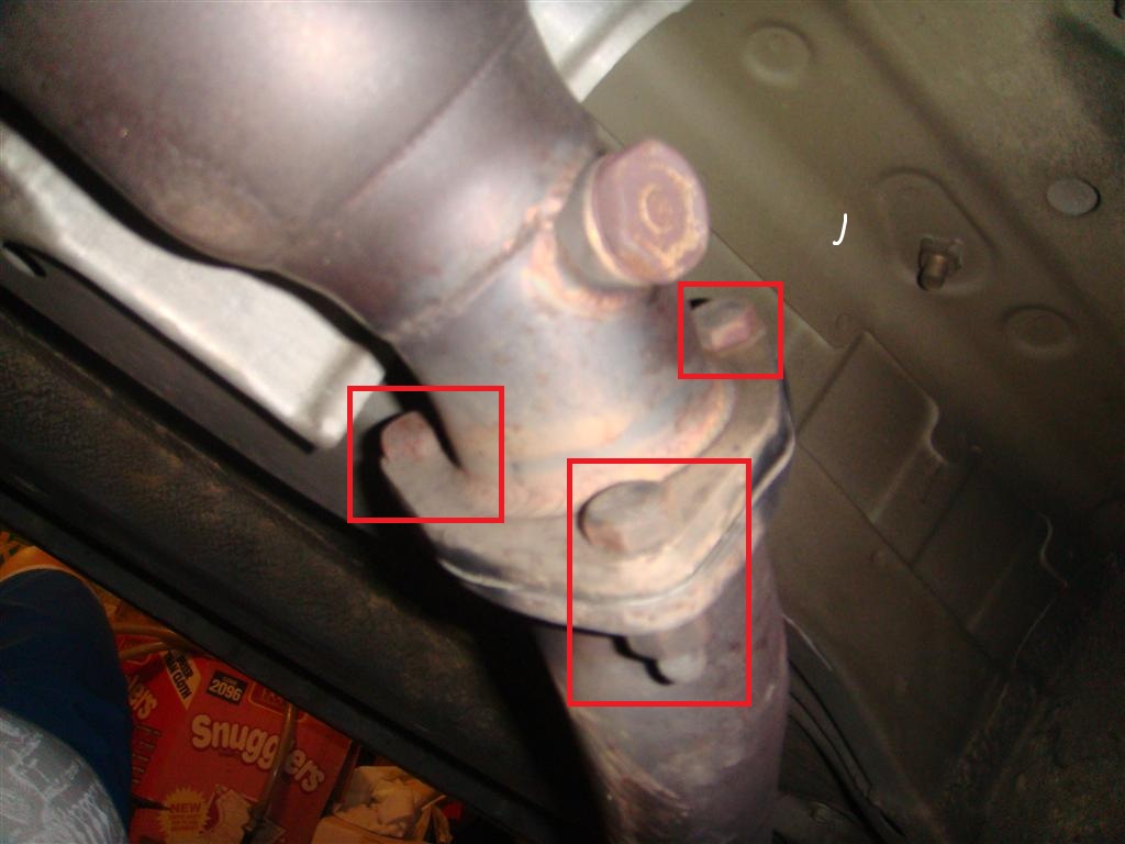

    4. Go underneath the car and remove the 3 bolts/nuts (14mm) that are used to hold the cat and catback exhaust together. (Note: on the stock cat, the bolt is welded onto the car so you need to remove the 3 nuts only)

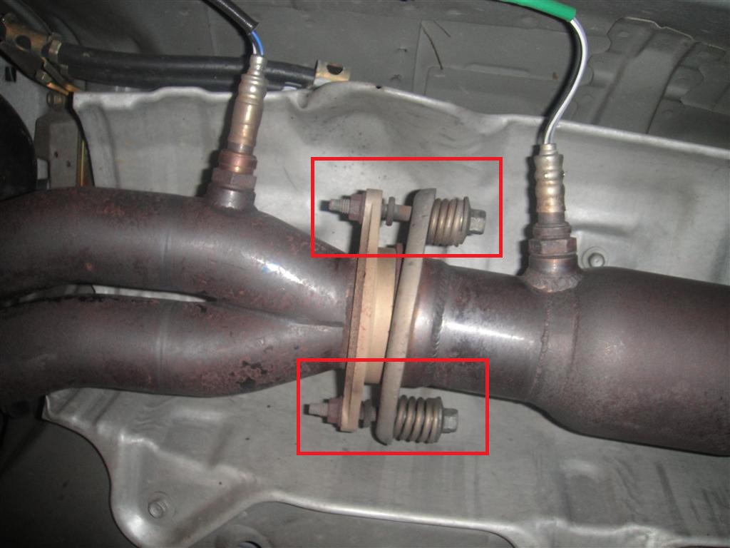

    6. Remove the 2 spring loaded bolt/nuts (12mm from memory) that holds the header and cat together. At this point the cat should be unattached. (Note: I had to do this as there wasn't enough room under the car to take the header off.
Name:	5 - Copy.JPG

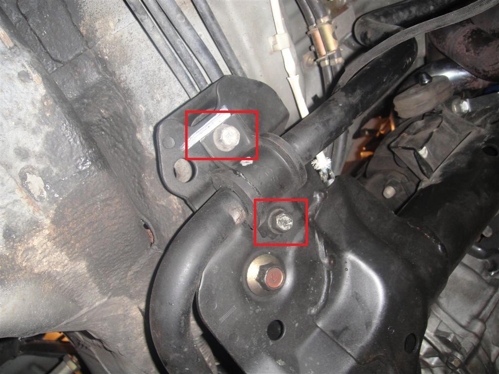

    7. Remove the front swaybar

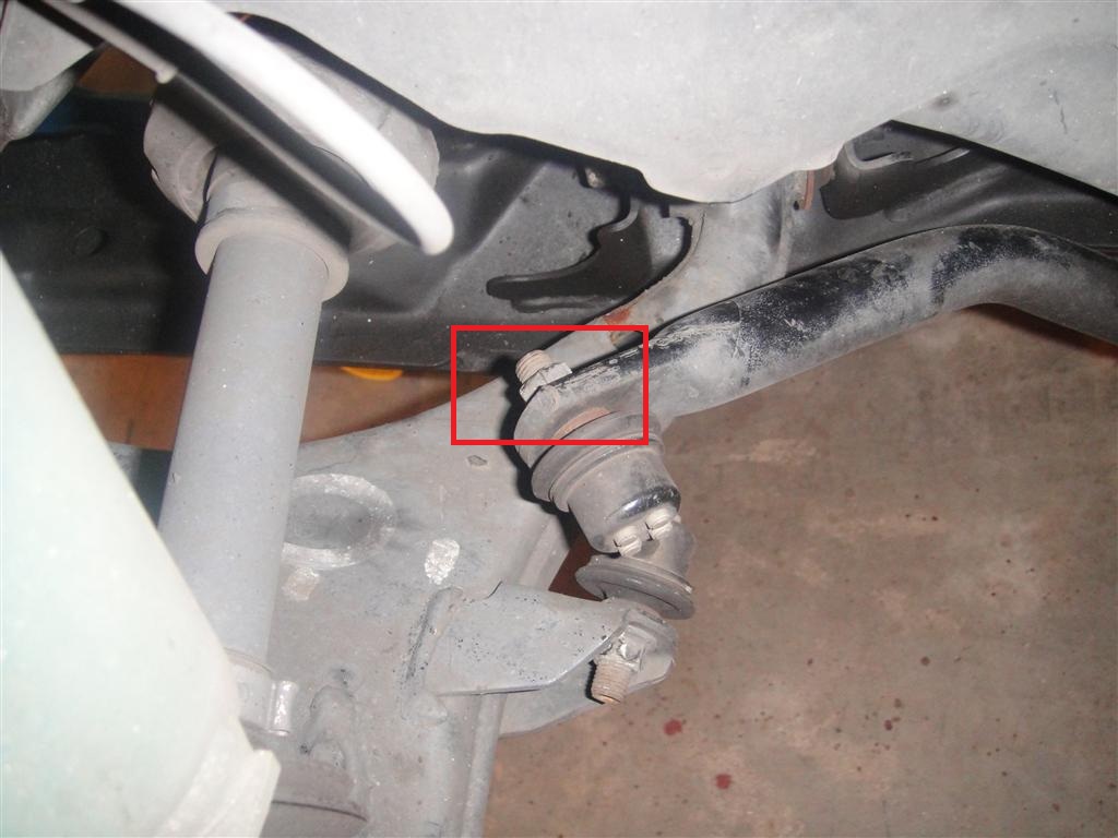

    a. Remove the endlink from the swaybar but removing the nut with a 10mm and using a allen/hex key to hold the bolt inside of the nut (You'll understand this better once you see it). Do this for the left and right side.
    b. Go underneath the car and remove the swaybar mount by undoing the 2 bolts (I think it was a 14mm). There are 2 mounts for the sway bar.

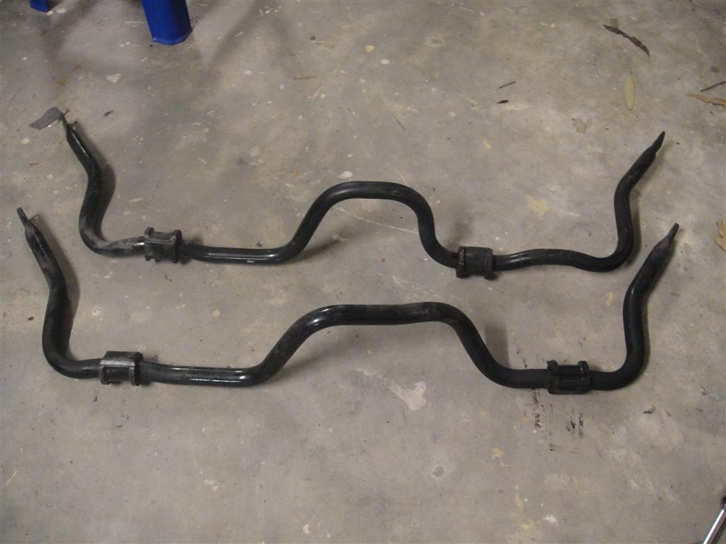

    c. This is the comparison between DC5R (top) and EP3 (bottom) swaybars. You can see the EP3 swaybar has more room to accomodate aftermarket headers.
    8. Remove the 5 bolts/nuts that you loosened in step 15.

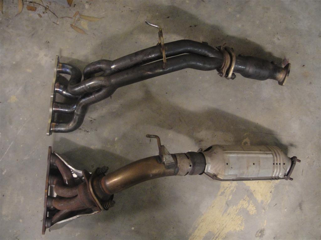

    9. Remove the header from the car. This is the comparison between Toda headers with cat and stock headers with cat.
ID:	18799Click image for larger version.

    12. Re-install the primary and secondary oxygen sensors you removed in step 5. Torque to 44Nm.

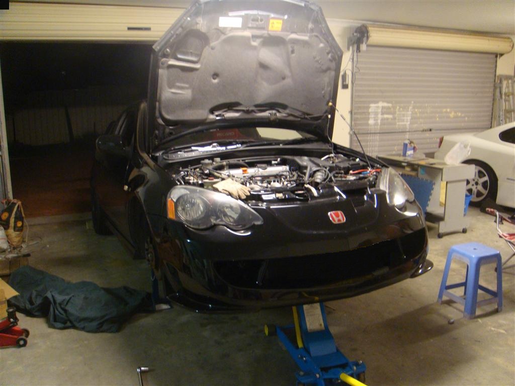

    wtf. thats some serious jack you got there.
    respect y0!
    S P A M | W O R K S
    With our special rotational tires, it will allow you to drive very fast. - JK Tyre
    Wollongong
    thanks mate.
    it's a Liftech LT150TLP if anyone is wondering. works well but weighs around 50kg so it's a little hard to lug around.
