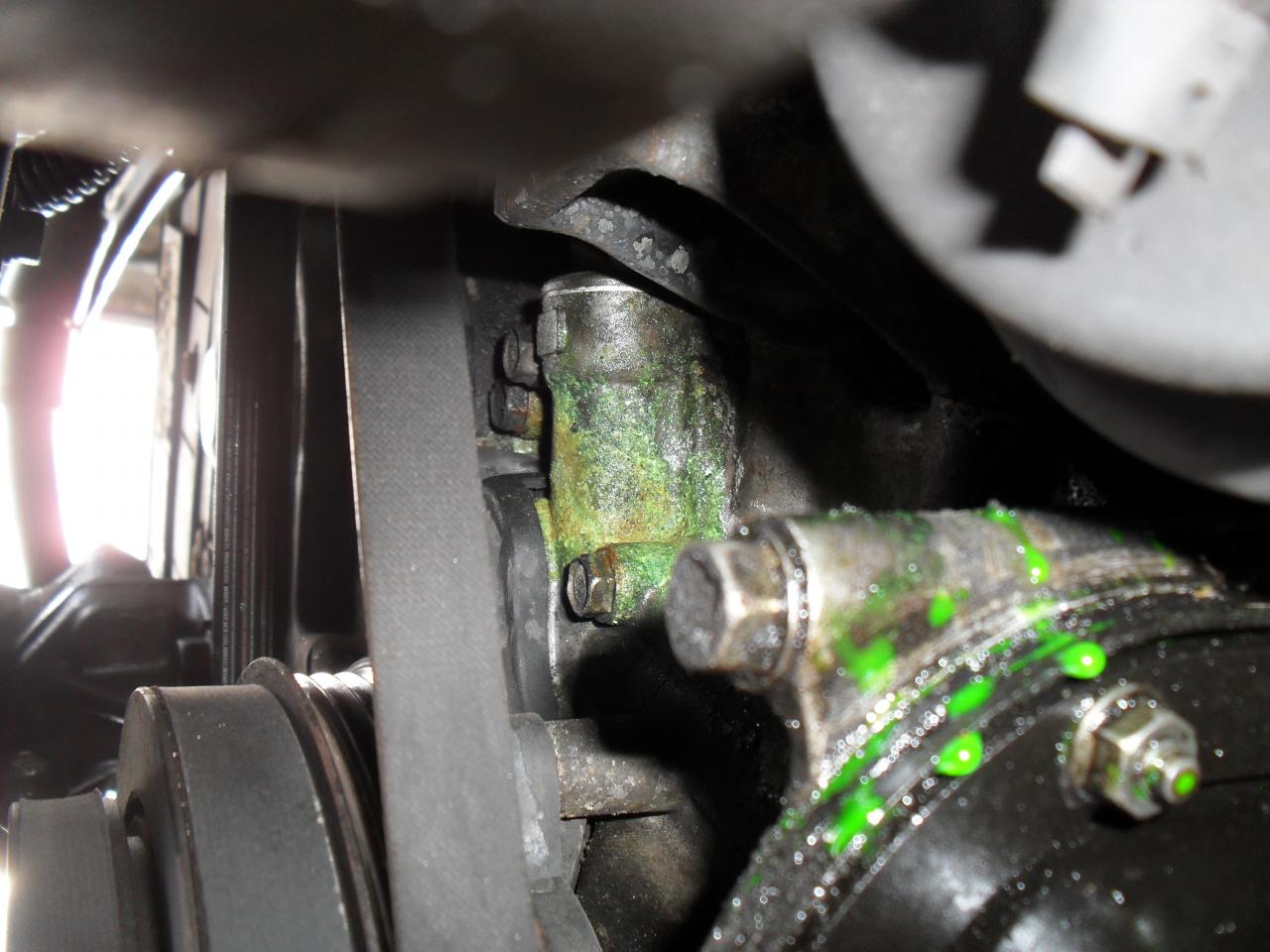

Need to pull timing belt covers off to see if it's leaking from the water pump's weep hole, from the pics it seems a likely possibility.
On the brighter side at least the coolant is still fresh green and not muddy water like in some cars.

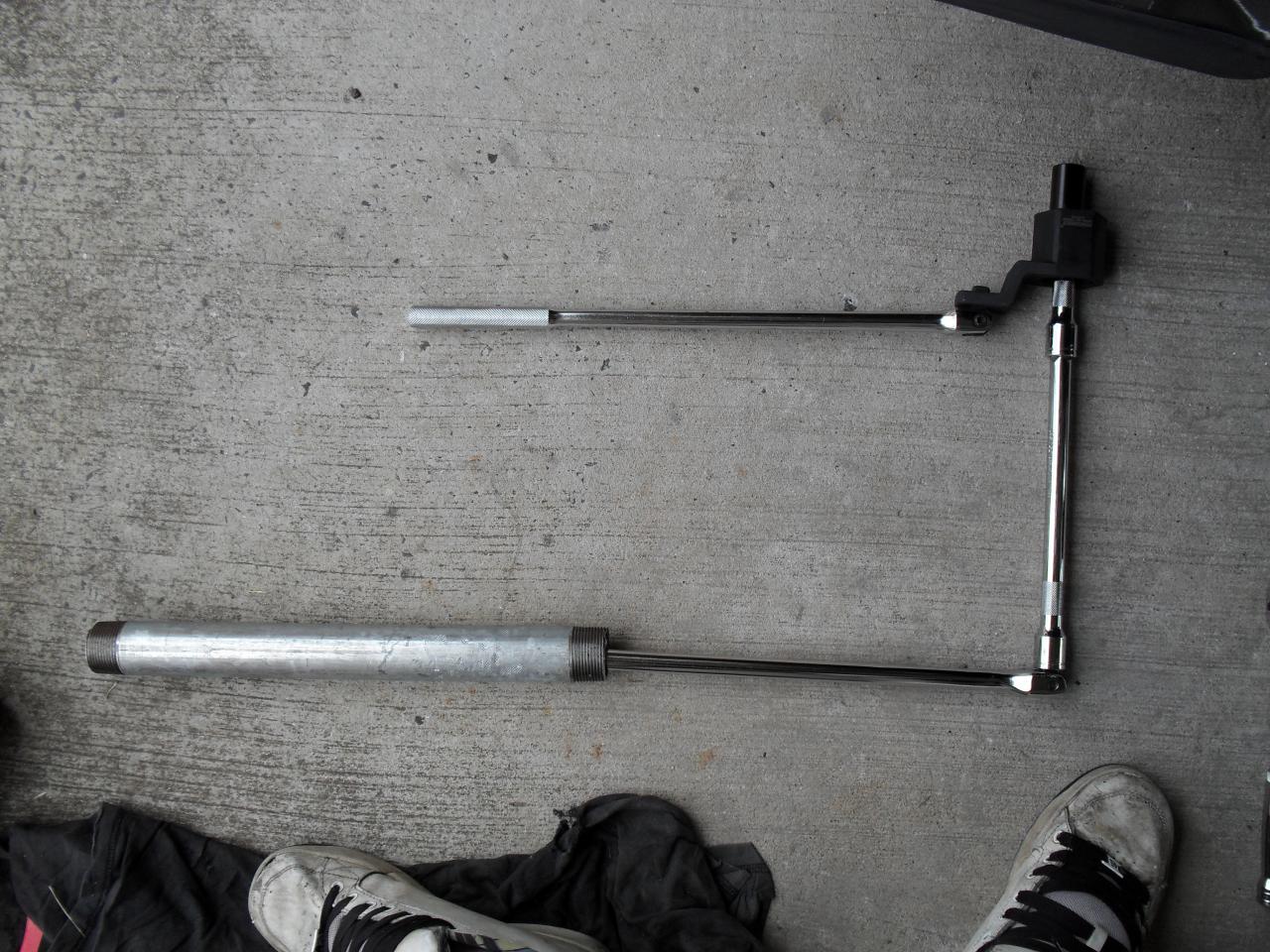

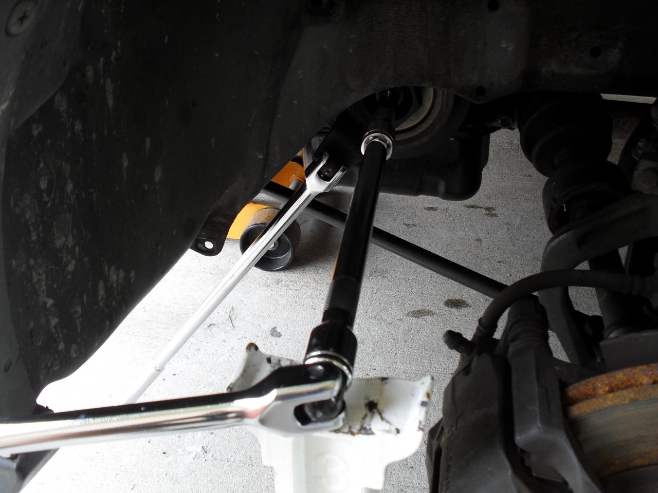

For anyone planning on doing a timing belt at home, and dont have access to like a $1000 air compressor with enough balls to get the crank bolt off, i would highly recommend getting one of the crank pulley holder tools that are on amazon. It cost me $26 from the states for the tool and then i got 2 breaker bars from supercheap (they actually didnt break i was amazed) and used this setup to get it off.
In the end my leak was indeed the waterpump, the seals had shit itself, but the pump itself seemed ok, it spun freely still.
