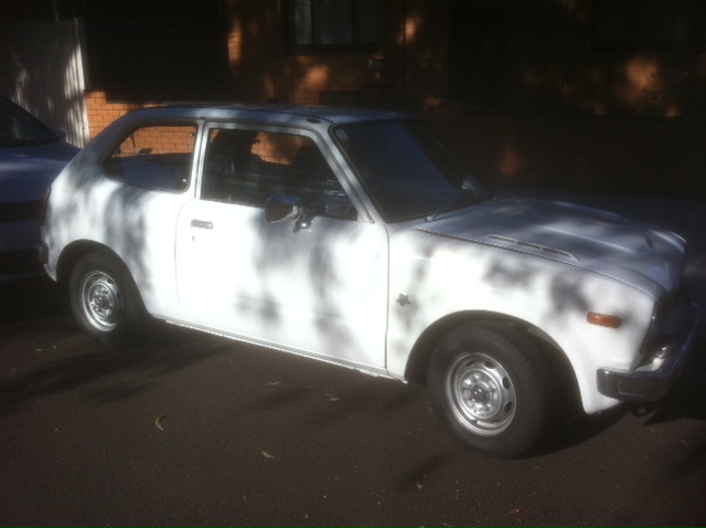

    Hi
    I'm about to put my lovely '77 Civic back on the road again but - though still drivable - the clutch is slipping quite badly. I reckon it will need to be replaced ASAP.
    My questions are please:
    Does anybody know how much I should budget for that sort of work?
    Can anybody recommend a good, reliable and reasonably priced mechanic in or around Melbourne who'll do the job?
    Much appreciated.
    Byron
