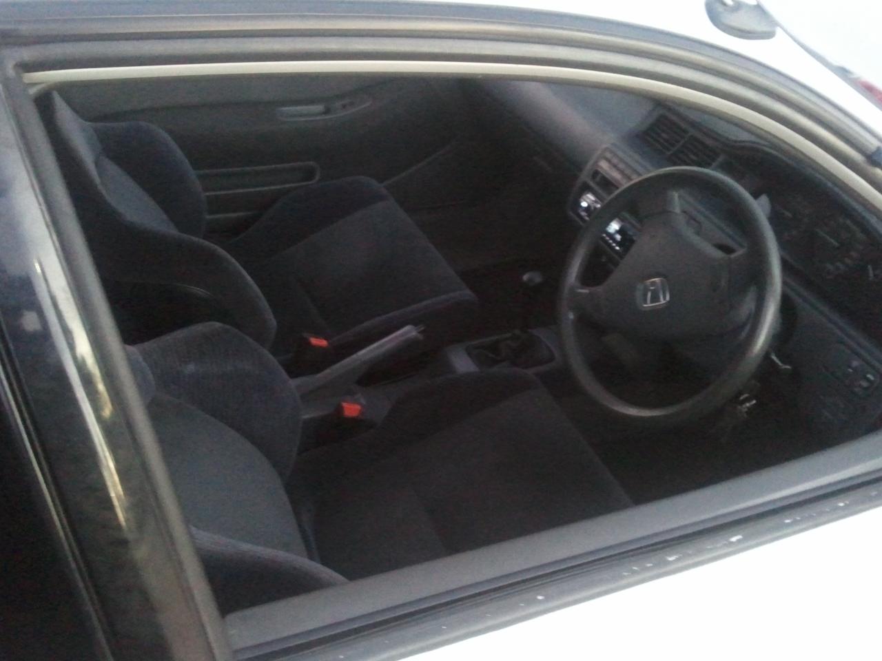

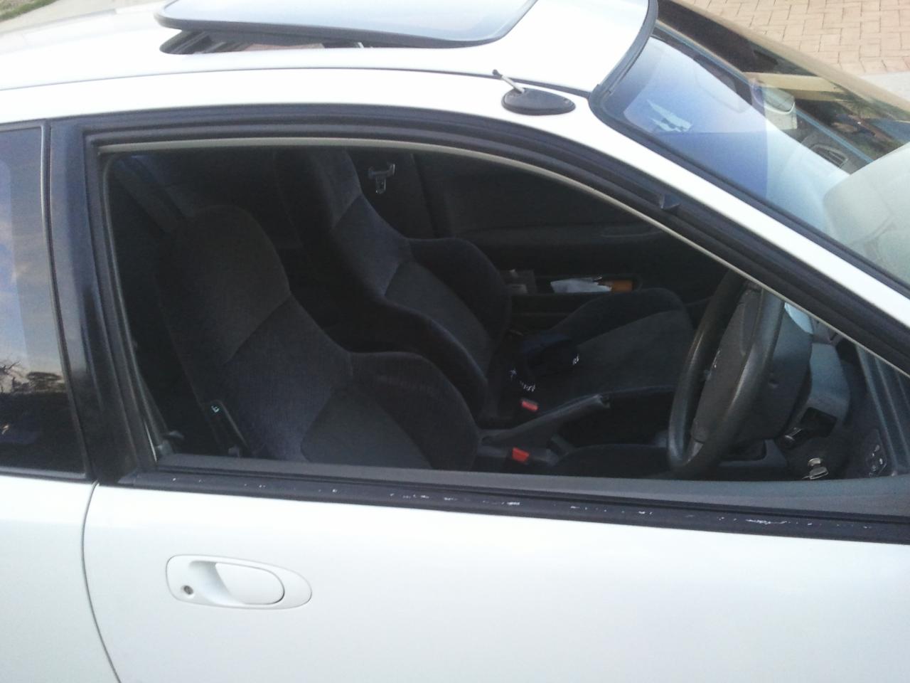

    Just wanted to know how much work it was for the Prelude seats? They look immac!

    and for your prelude seats.. what did you have to do to make them fit in terms of rails and stuff

    The seats werent to much of a drama. use the standard rails from the lude. bolted the rear first then the side closes to the gear lever,then bored_out the side closes to the door. used a washer configuration to bolt the drilled side.
    Little bit of a sweat but wasnt to difficult.
    Worth the hassle.
