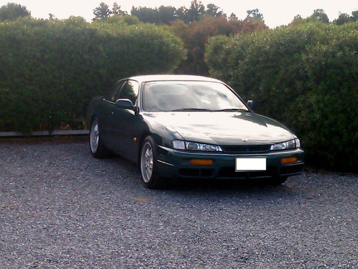

Got pics of your kouki?
yeah the idea is just that buy a cheap run around car that i wont mod until the engine decides to go bang. at which point ill toss up between another cheap d15b4 engine for swap, scrap it or depending on the situation i might drop in a new high comp engine, upgrade suspension etc and turn it into a track beast.
As for Kouki pics found one not the best but she is due for a wash so ill take some good photos then

Looks good! Somehow the green seems appropriate in picturesque Tassie.
Yeah she does look good was bone stock when i bought her and only had 85,XXX km, one owner was a very good bargin. Now she has Full suspension arms, 17x8 wheels with 225/45 all round, poly bushes to go in when the rubbers are worn out and HSD coilovers tho the rear right damper or top seal is gone so gonna have to get that fixed.
Apart from those she is still stock engine/intake/exhaust is untouched tho end of this month will be one year of owner ship so i might buy her a turbo back exhaust. Also police leave me alone which is sweeeeeeet ^_^
