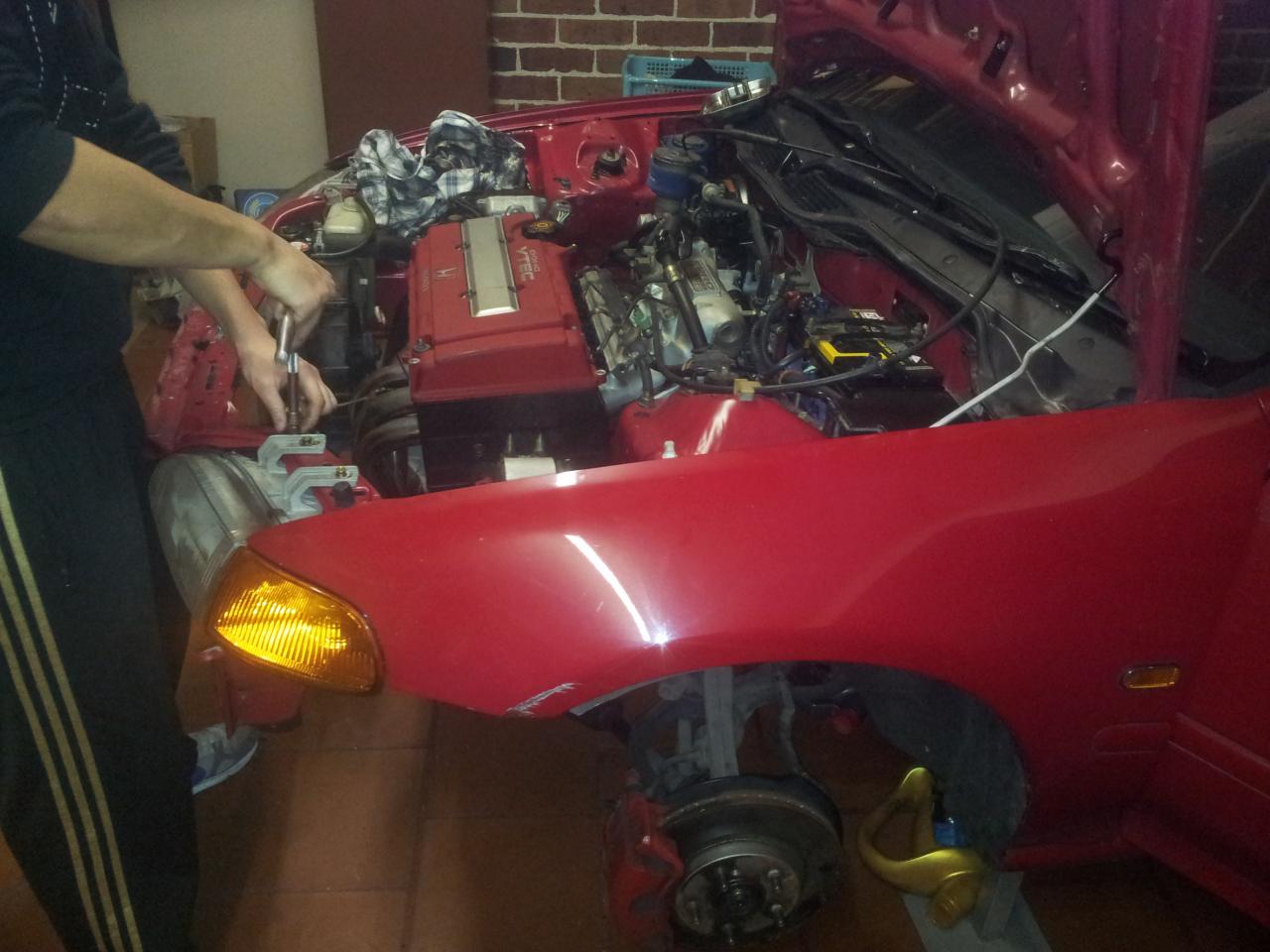

    remove the headlight which you want to modify by unscrewing the 10mm bolts securing it to the car (this will likely involve removing the front bumper). For the EG there were about 5 in total (just look for them). The headlight and blinker should come off as one piece.

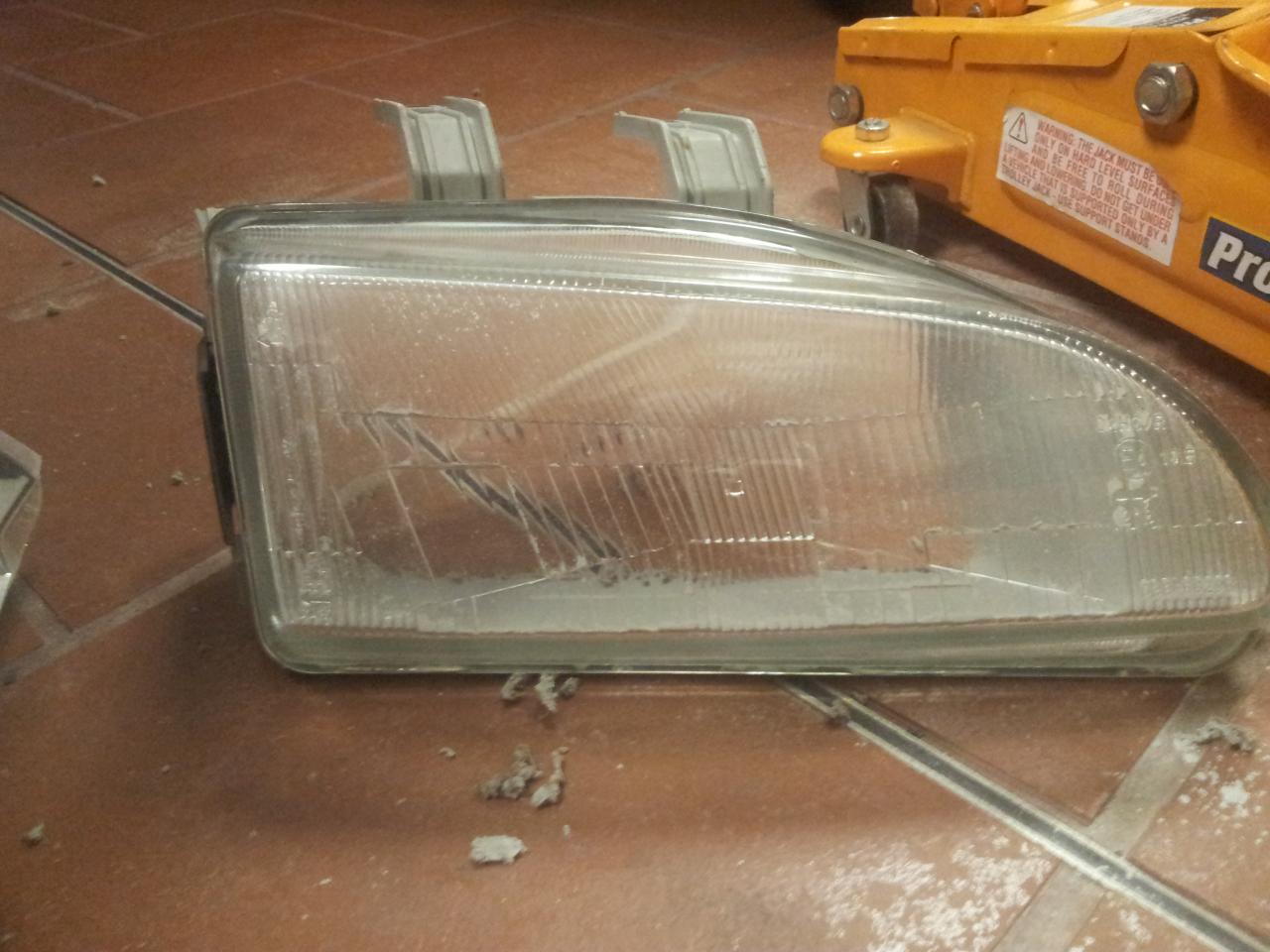

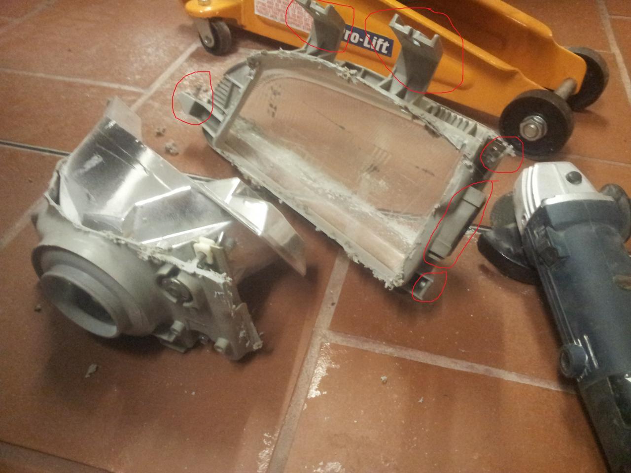

    grind out all the inside of the headlight. Make sure you leave all the brackets intact as shown in the picture. You might want to mark the area you want to cut before you cut it. The idea is to cut out as much crap as you can while leaving all the brackets.
    Also, looking at the next picture, I've left some plastic on the right to create a nice funnel effect, since when the headlight is reinstalled there is just some metal in the car's frame behind that bit of plastic, which will create more unwanted turbulence. This bit of plastic I am referring to is also necessary to keep there (in the case of the EG's headlight) in order to keep all the brackets intact.

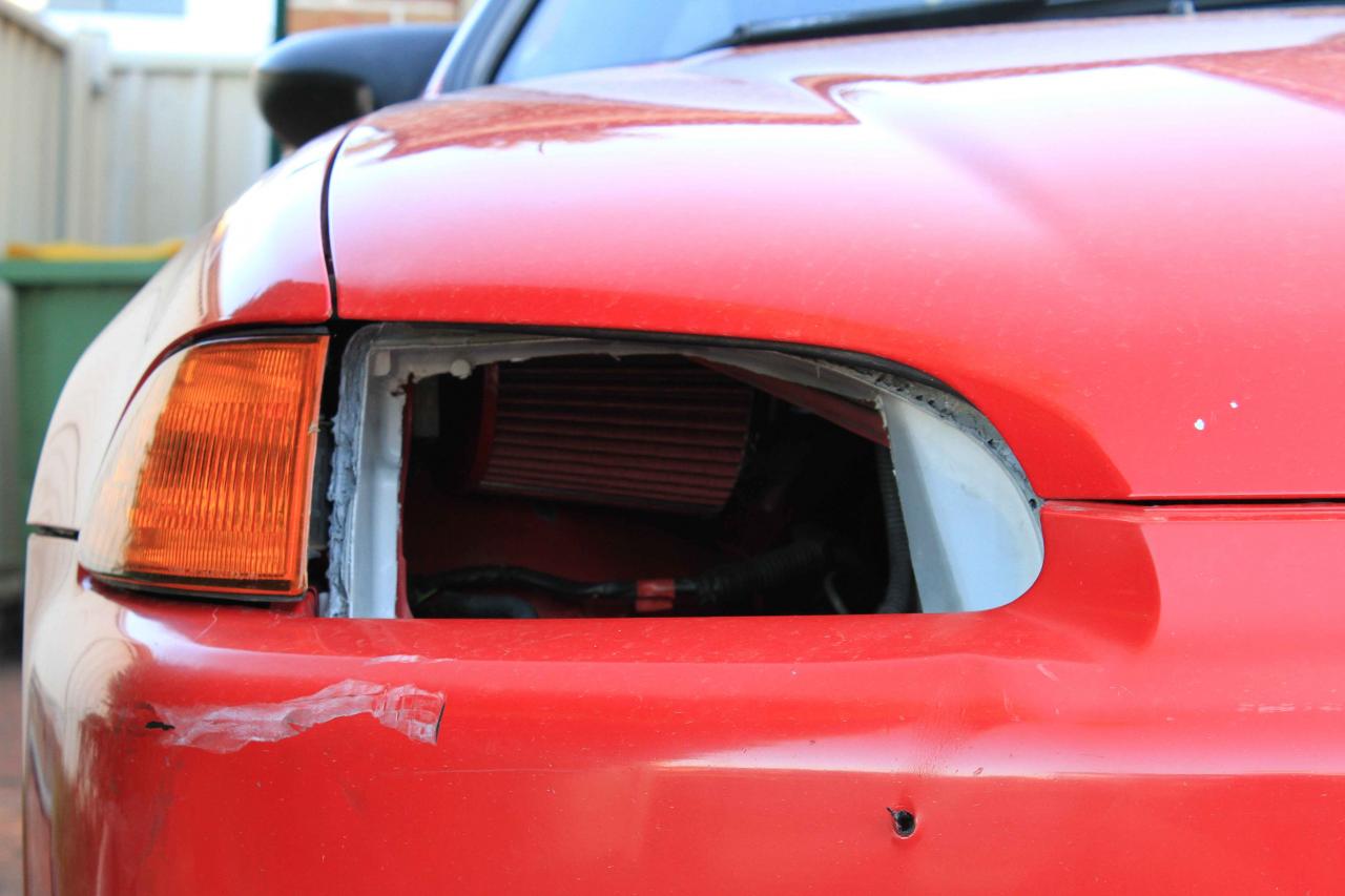

    rejoin the blinker to the remaining mutilated piece of the headlight and reinstall that to the car just as it was fitted originally. It should look something like this:
    In these photos you can see the melted part from the heat gun (where the glass and plastic was joined) and the bit which has been ground off. Have a peak through and you can see the air filter so the air goes directly into it.
