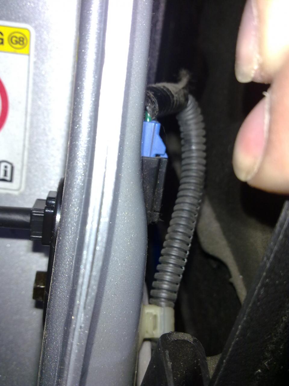

    Need help here. My driver's side door ajar sensor isn't working.
    I've tried troubleshooting the problem, all the power windows, central locking and speakers are all working, I get a power reading of 12V and 9V for my courtesy light.
    For all the other doors, the interior lights turn on when open and the door ajars are working when I press them.
    The driver's door ajar, however, isn't registered by the car that it's open. I don't see the red line/light for the drivers door on the dashboard when it's open. Light's won't turn on either.
    I've checked the connection from the inside, and it's secure, not sure what/where the problem is. I have a feeling it may be the Body Control Module (BCM). But I am not sure where it is and which wires/pins to look at.
    Could also possibly be the wiring, I am not sure how to take out the drivers door panel, so any tips or advance on how to would be much welcomed as I don't want to pull too hard and break something or wrap the plastic.
    Any help or advise would be much appreciated. Thanks in advance!!

    Maybe that black rubber housing from the first pic isn't working?
    Im sure you can peel back the rubber and test the voltage/ground/connection to it?

    The black rubber housing you're referring to is the door ajar.
    I've tested it, no reading. Bolt's really firmly secured too.

    The black door switch has probably failed. Could be corrosion in there.

    No, no signs of corrosion. Though I wish it were that simple. I've taken it rubber cover off and it's perfectly fine, no current/voltage reading though..

    test all the wires going into it for power.
    removing the drivers door? dont see why that would help but im not sure of the model.
    should be removable by searching for screws in all the common places.
    http://www.ozhonda.com/forum/showthr...ving-Door-Trim
    sometimes the light is actually controlling that circuit so to speak. so if the LED is broken in the cluster then the current wont go through and tell the switch to turn on the light.
    dont know if thats your case or not.
    but in your fuse box, you could find some more clues, i remember my door open sensors on the jazz went to the fuse box for some reason.

    I'm referring to the door panel (the plastic bit where the boot/petrol cap lever is. not the door trim. I've removed the door trim countless times, so have no problems with that.) As I've said, the power windows, central locking are all functional. I've checked the socket inside the door that's covered in sealant, just to be sure.
    The car just won't register that the door's open.
    I've tried switching it with other bulbs, and used the original OSRAMs which were in perfect working order. However, not one bulb was lit. I've tested the power readings of the socket and has a 12V and 9V reading. So there is power to it. It won't turn on because the car doesn't see that the door's open.
    I've checked the interior fuse panel and under-bonnet one too. There are no broken fuses.
    I checked the bolt again, and found there was a resistance reading (same thing went for other doors too). I'll try to get a reading for the wires, but it's kind of hard with the middle door panel in the way (the plastic bit on the side where the seat belt is). I can't remove it without first removing the driver's door panel.

    The door panel on the bottom next to the boot lever? Yeah, it's just one of those "pull carefully" type of trim. There are no clips or screws. I can get more detailed info for you once I get home. With that off, you should be able to trace the wire back to the fusebox, hopefully it is just a loose connection since you are not getting 12V to the switch in the first place.
