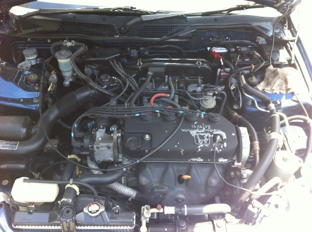

Every morning when i try to start the car i have to press the petrol pedal all the way and after it start i have to keep my foot on it other wise the car will shut off. I have changed spark plugs and distributor cab but still. Any ideas?
Attention: its a dual carburettor, not injectors. Some people told me that the carburettor of this model always screws up is that true?
Also when i start the car in the morning and i keep my foot on the petrol it gives black smoke and u can smell petrol in the smoke, but once the engine is warm the car is normal and no smoke comes out. Any suggestions?????

Alright, change fuel fuel filter, check all vac lines, and at worst, get carbs rebuilt

it's the choke..that's messed up..probably the wax in it..i think it's gonna cost u $800+..which I don't think is work it....can be fixed with a cable tie easily
