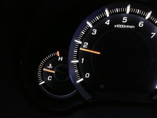

    Yeah man it is warm when I check it,
    Here's a pic from last night Click image for larger version.

    Quote Originally Posted by ExpressCoffee View Post
    Also, is the climate control set to recirculate? If you set it for fresh air, the cold Melb air plus high fan means there is not enough time for the heater core to warm up the air coming in.
