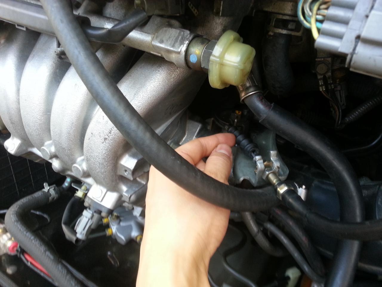

I've attached some photos to explain what I mean.
What the cable should look like. should return to this position after accelerating.

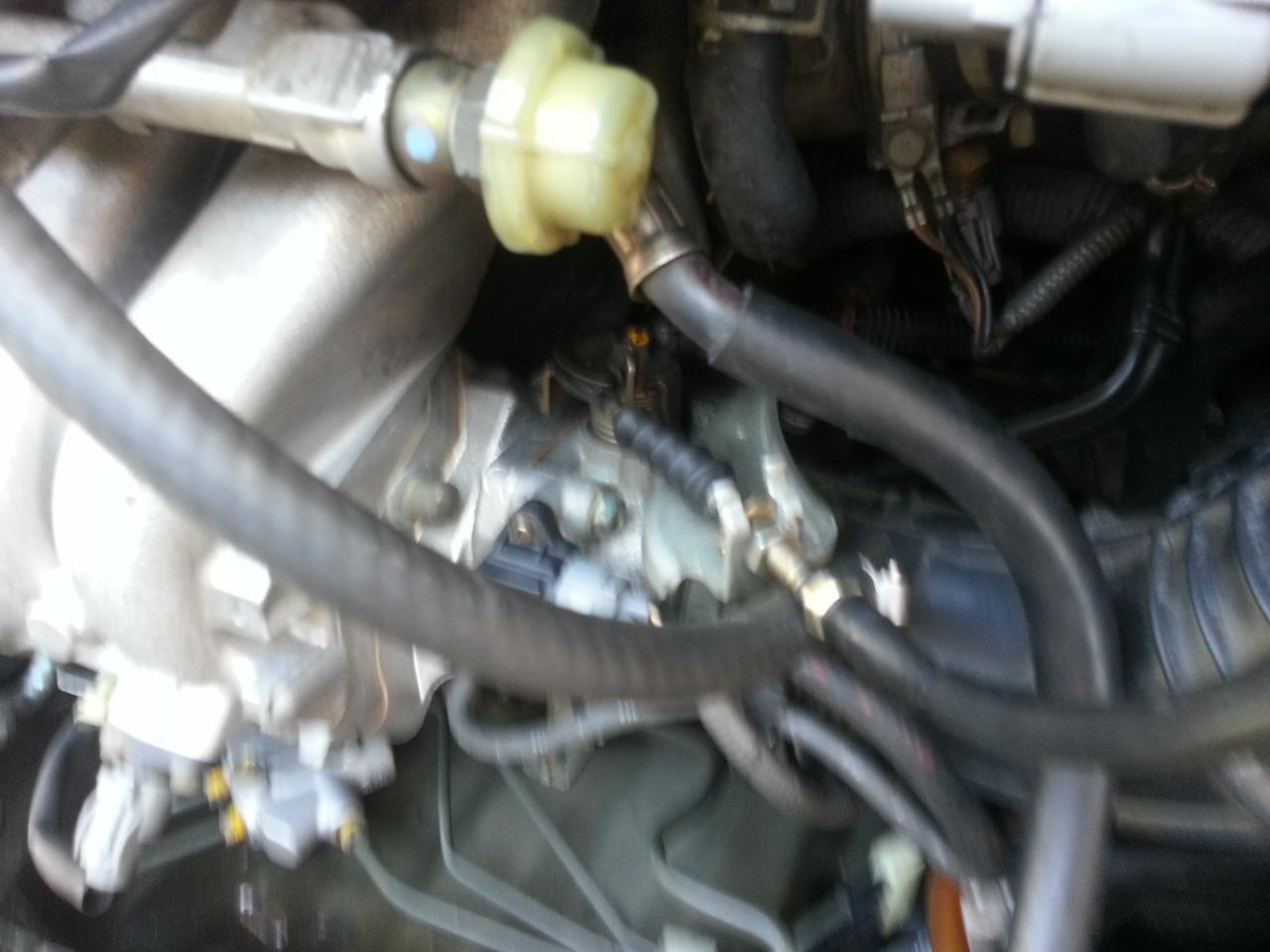

Position the cable was stuck at, causing the butterfly valve to be stuck open and the 3k rpm idle.
