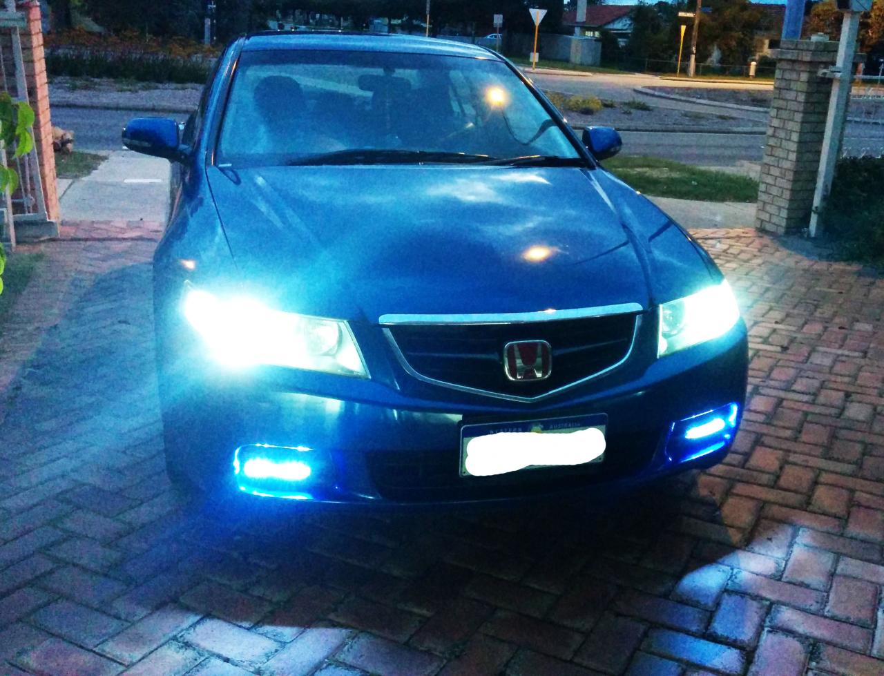

    Finally got around to fitting them on!
