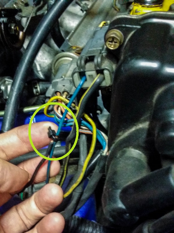

    Long story short, the EG civic breeze had a B16a2 conversion done. I admit whoever did the conversion was a real cable tie tech - I've never seen cable ties used to plug the cam cover hole or splice the tach wire signal:
Name:	splice0001 (1 of 1).jpg
ID:	29100Click image for larger version.
Name:	splice0002 (1 of 1).jpg

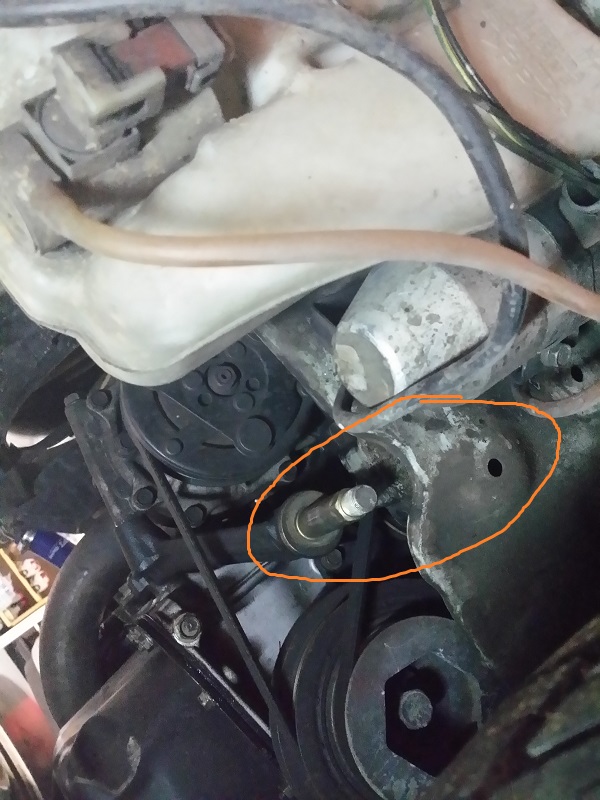

    In any case, I replaced the O2 sensor earlier tonight and whilst under the car, noticed this metal rod protruding out near the crank shaft. I'm pretty sure I've heard somewhere that on certain models like DC2 Integras they had an engine mount here - refer the circled orange bit:
    Welcome anyone's thoughts - the previous owner drove without it so I'm thinking it's no biggie but if I do need one, then I'll have to scour Ebay then for the part.
    Long way to go yet - with any project car you basically inherit the handiwork of the previous owner.
    I am sure I will be asking a lot more queries here as I work my way through each issue getting the car closer to being registered again.
    Cheers.
    you are missing your front lower torque mount. It is rubber encapsulated in a C shaped metal enclosure and is held via that large bolt and a large nut. You can get a new one , or change your side and rear engine mounts to heavy duty hasport/innovative or similar and not worry.

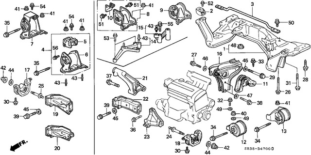

    (http://www.lingshondaparts.com/honda...9&block_05=hcr)
    From this diagram, you are missing part number:
    18, the lower torque mount.
    30, x2 bolts.
    44, washer.
    42, nut.
    You can also get these parts off a wrecking EK Civic, CRX Del Sol, DC2/4 Integra and I've did a quick Google and first gen CRV too.
    Is the other side's torque mount there?
