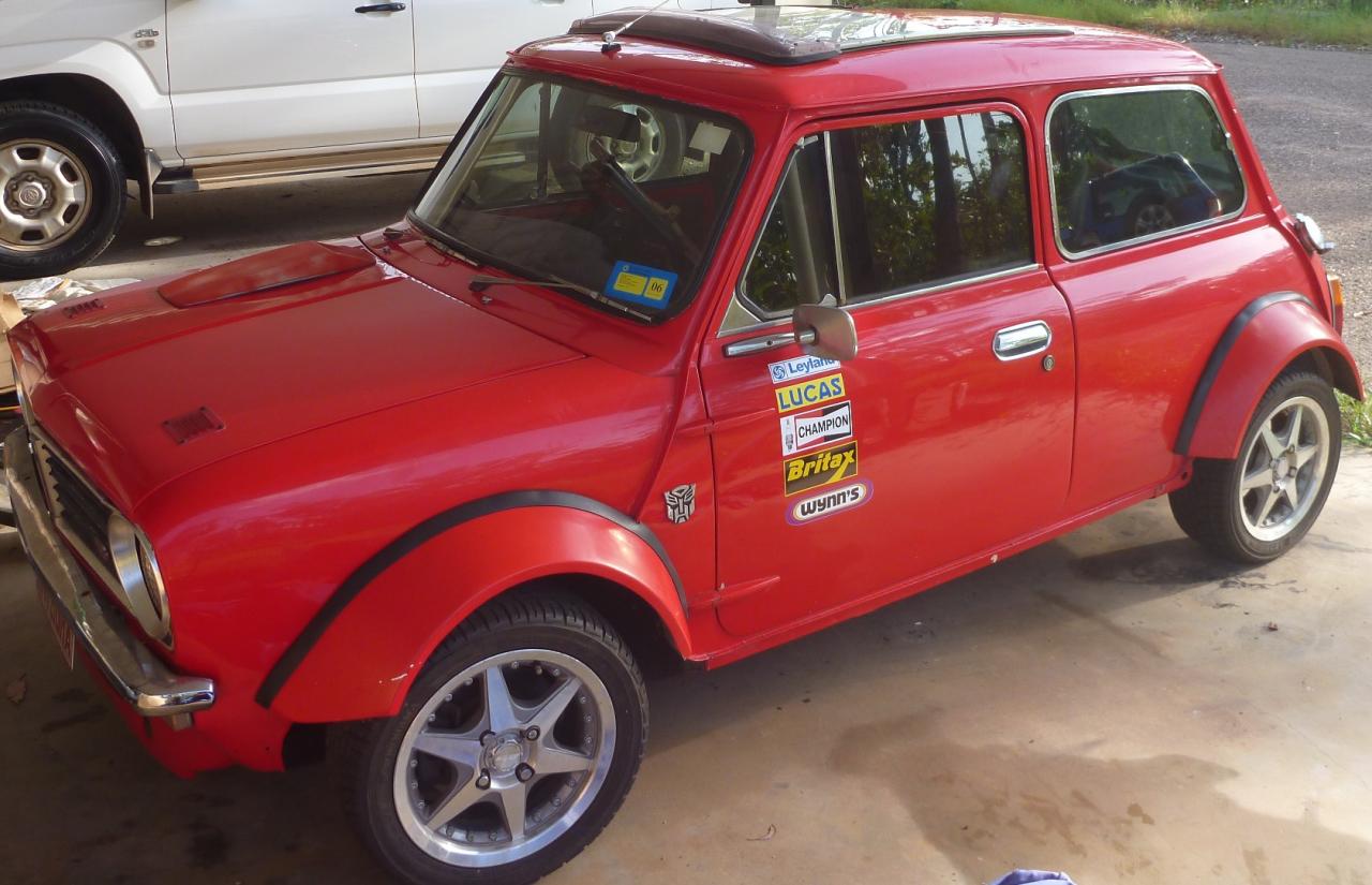

    Oct 2006
    JDM B18C Leyland Mini
    OK, thanks guys.
    Can't wait for the little beast to be back on the road!
