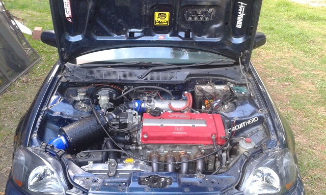

155,000km,220/220/220/200 compression tested,PLM 4-2-1 big tube headers,had just had a major service when the car was hit on the rear left,twisting the chassis and writing it off.It was at Cabramatta,I am 3 hours south.I have done an engine and manual conversion in my car before and now I had money so it made sense to have a little holiday and let others do the work I drove up,stayed at holiday inn for 2 nights,1 extra just incase there was any problems.Lucky I did,because my car was originally automatic there is a tunnel in front of the gearstick that the shift linkage was hitting.So Thanh,who did the install cut it out and installed a carbon fiber piece there and it looks tops.He drives a black S2000 and frequents wakefield practice days.His mate who helped him works for Toys Garage and drives a CRV with a lift kit and oversized rim/tyres.

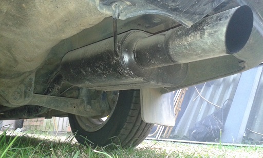

Exhaust is 2 1/4" FULL stainless steel mandrel bend,flexi pipe,200 cell metal hi-flow stainless steel cat,12" res,Flowmaster delta 6 series muffler which is AWESOME,no noise in the cabin and it is a perfect blend of engine roar and exhaust note,it really did work out exactly whay I had hoped for,no rasp,deep note but dosen't say look at me,it's QUIET but turns heads to the awares if you know what I mean.I love that.
Was $750 all up,got the b pipe with res off Thanh cheap

Fully enclosed Fibreglass pod filter box with cold RAM air

There was a nice whistling induction sound before the enclosed pod filter box went in but the box gave it a deeper note again,beautiful and now all that hot air coming out the back of the radiator is not pouring onto the pod filter and therefore into the engine,robbing power!
