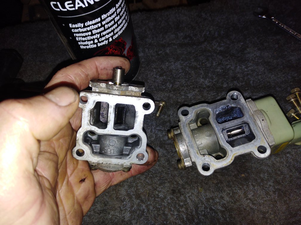

    To solve this you need to remove the throttle body as shown here
    http://www.ozhonda.com/forum/showthr...ting-Look-here

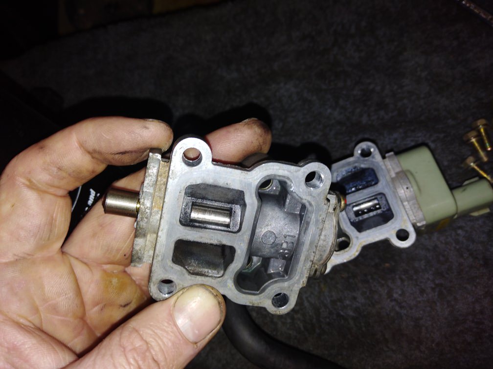

    1. you then need to remove the IACV from the throttle body.
    if you look closer you can see the "tongue" of the valve slider section. that needs to glisten. with my IACV I removed the electromagnetic component - be AWARE there is a glued seal underneath, it WILL become a little damaged however this is predominantly related to keeping moisture out - I havent researched if it can be bought - however there are types of glues that are able to make those sort of tiny "gaskets".

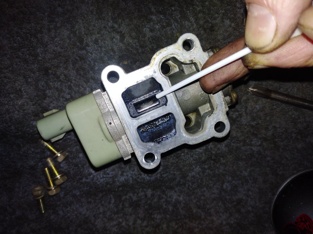

    1b. removing the Electromagnetic component allows you to slide it back and forth - with my IACV it would NOT move, it had that much sludge.
    2. you need to clean the IACV chambers and slider with Carb Cleaner, perhaps a toothbrush and tiny cotton buds.
    3. when it shines, then reassemble. (I am NOT certain about the distance the slider tongue needs to be before the controller side is added again - i took a photo and ensured it was the same gap. there is a chance that the controller side has a specific range.) The magnet will SNAP back in place when the controller is added.
    4. reassemble the Throttle Body etc, put your car back together.
    My car run smooth as new.
