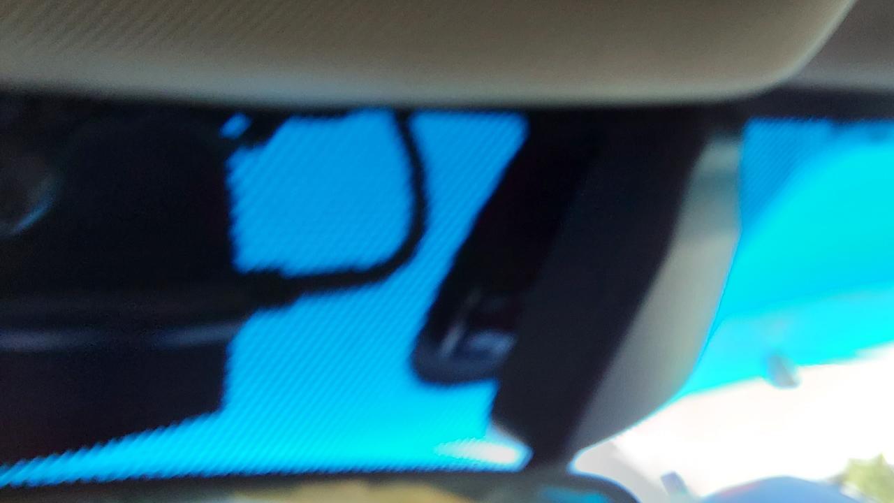

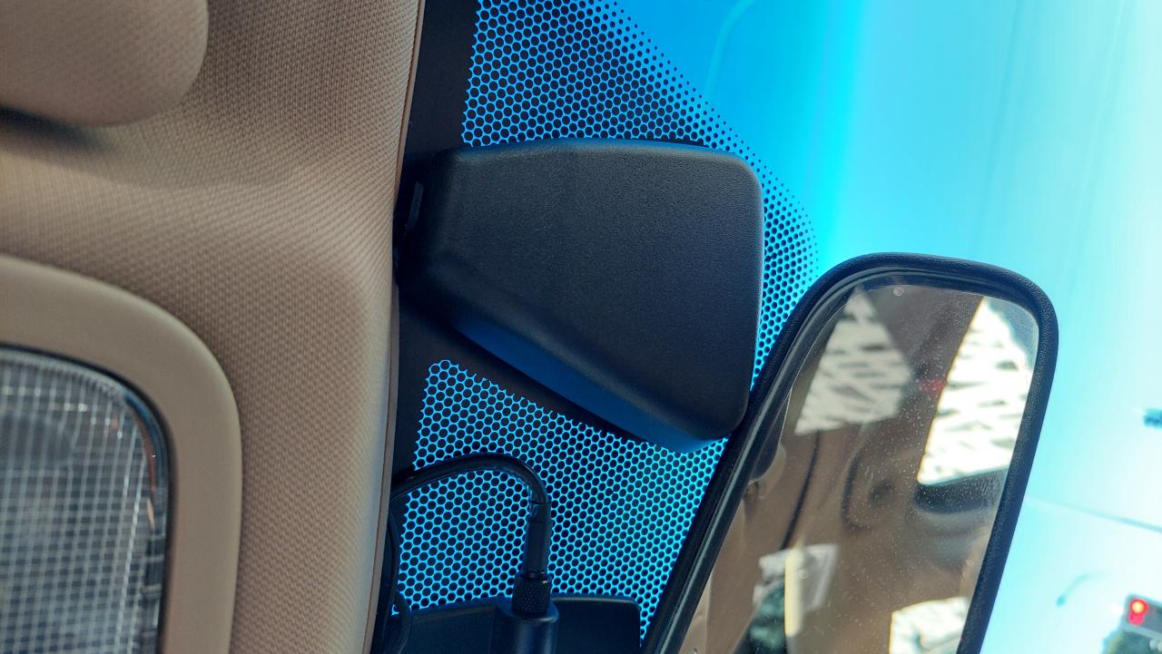

    Hi Kodak
    Thanks for the response and apologies for the delay in responding but haven't been in the car for a few days. I have attached the photos. They are not great quality because the background was outside daylight. I can resend them by taking the photos indoors and front lighting. Let me know if you need that done. Grateful for the help.

    Here is the diagram from the service manual. You can see the two clips that hold the cover in place. I suspect you need to hook in the wide side (bottom) first, and then engage the clips shown in the diagram.
