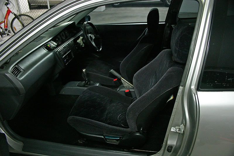

Don't be scared to saturate the carpet, as that is how dye works. ALSO, Don't get scared if you start to see grey patches! this is because once the carpets saturated and damp, light reflects off it making it appear grey. If you are that worried, spray some more on. The salt you added before helps the dye spread at a even rate. Should begin to look like below
STEP SIX: Once you have done one layer / coat of the dye, repeate process around 1 - 2 hours later (same as above with the second tin) It'll start looking more black like below.
STEP SEVEN: Don't drive your car for a day or two (hence why i said remove the carpet! Take a peep at the carpet, if you are happy (like I am), simply fit the carpet back and use floor mats, and the dye will last a long time! If you are unhappy / there are patches, repeate process again. It won't hurt doing it a few times. As you can see, mine came out like this. IT looks pretty cool!

Some pics
IGNORE the passenger side, has a faded floormatt in it. Look at the drivers side
