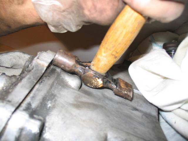

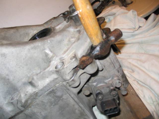

The next bit is a bitch to do. You basically have to whack the spring clip out (use a hole punch or the like, i used a bolt that I had lying around) so you can seperate the spring clip. It requires a heck of a lot of pounding to get out!!! I actually couldnt be bothered pounding it under the car, so I undid the linkage at the base of the shifter and lowered the tranny with the linkage still attached to the tranny.
(Below: Shift linkage on the left, stabiliser linkage on the right)

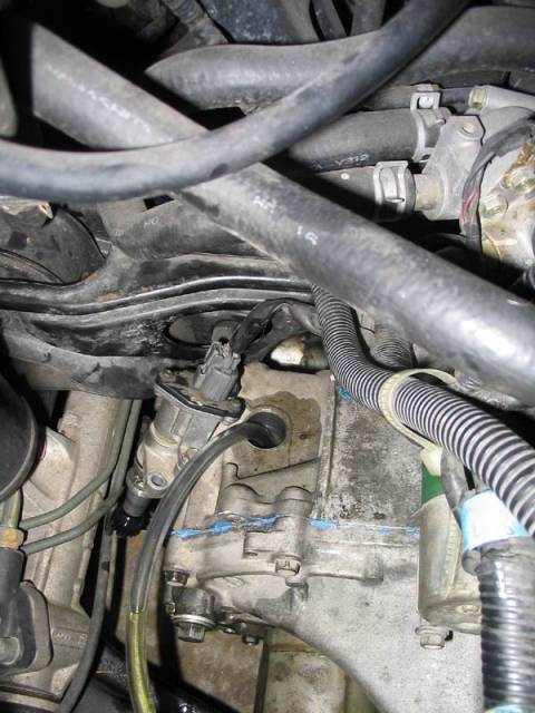

11. Once this is done, get out from under the car and move towards the top. Firstly you need to unplug the following connectors from the top of the transmission housing. (It is best that you take out your airbox and intake arm to get easy access.)
A. Vehicle speed sensor (VSS)*
B. Backup light switch*
C. O2 sensor connector
D. The two connectors going to the back of the starter
*You do not have to take these sensors out yet, just unplug their connectors

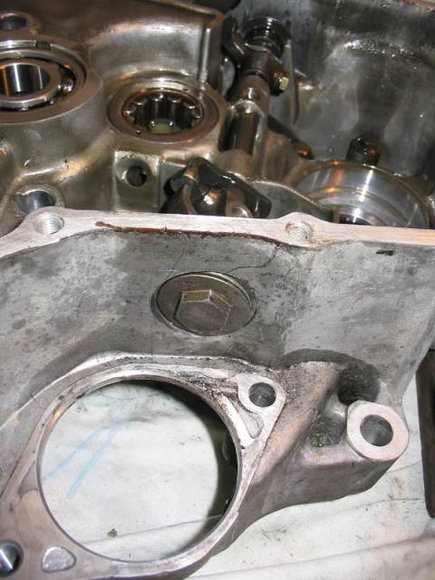

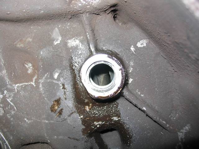

23. Undo the 32mm sealing bolt using a 3/8inch drive.

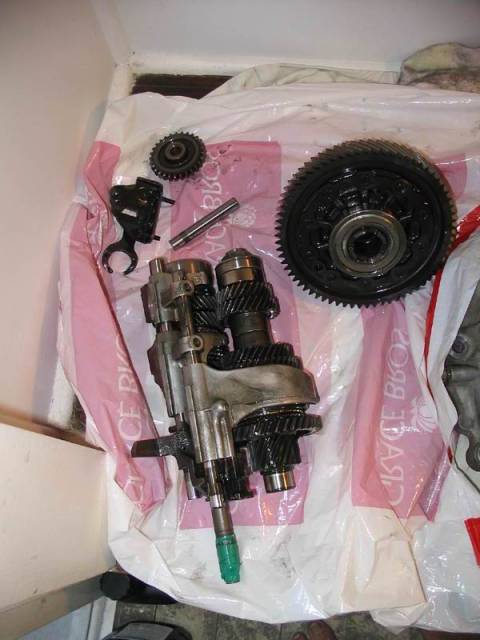

30. You can now pull the shift fork assemblies and gearsets straight out of the tranny. Just grab the mainshaft and countershaft assemblies cleanly by the gears (not the shycho hub/color) and lift straight up. A bit of wiggling may be required.
31. The differential can be removed by lifting it straight out of the clutch housing.
From the top - Reverse Idler gear, Reverse shift holder, Reverse idler gear shaft, Differnetial and mainshaft/countershaft/shift fork assemblies.

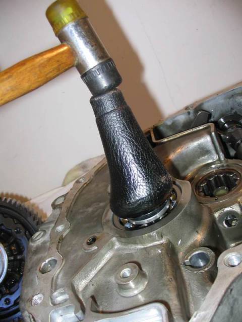

32. Getting the ISB out is pretty easy. Just go in through the clutch housing side and tap the ISB out using a long extension and 5/8" socket. If you have trouble, just heat up the area around the ISB with a hair dryer.

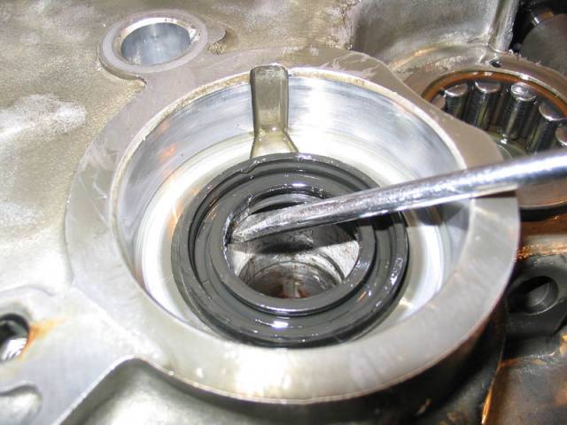

33. Take out the oil seal using a flat head screwdriver.
34. Put a new oil seal in (lube it up a bit with some oil before putting it in), then put the new ISB in and tap it down with even force. I put mine in the freezer for around 10 mins so it would go down easier! Ohh......and the trusty stock honda shift knob does still have a use!

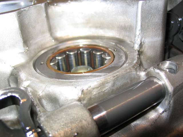

35. I also noticed my countershaft needle bearing was sitting out of its seat, so I just tapped it back in.
Before:
After:

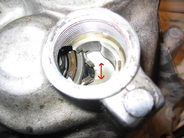

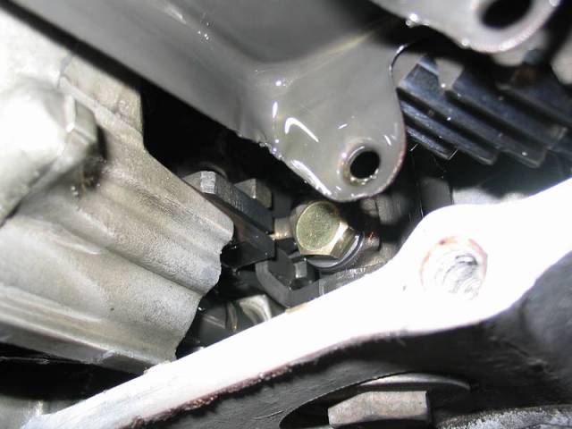

36. Once you have changed the bearings, I suggest you take out the 28mm plug bolt and 1st/2nd select spring so that you can turn the interlock in order to align it with the base of the shift forks.
Plug bolt @ base of picture:
